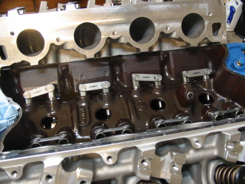

Stabbing in the cam...
http://i170.photobucket.com/albums/u...IMG_0043-3.jpg
http://i170.photobucket.com/albums/u...IMG_0045-4.jpg
http://i170.photobucket.com/albums/u...IMG_0046-1.jpg

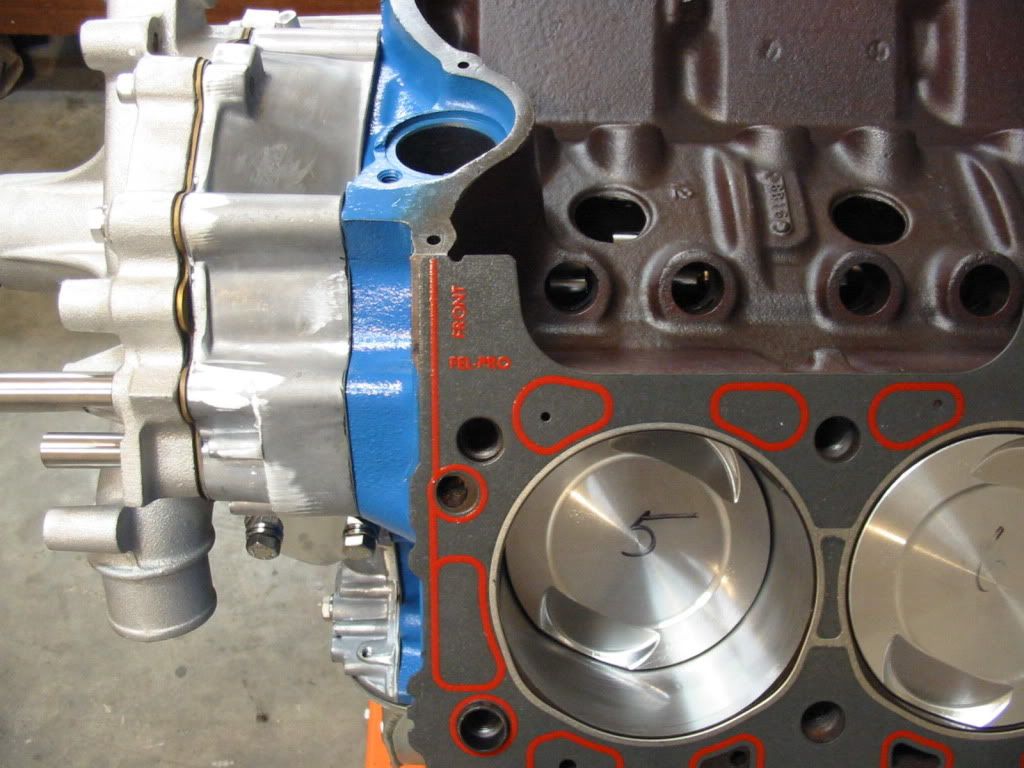

Setting the crankshaft...
http://i170.photobucket.com/albums/u...r/IMG_0063.jpg
Tada...
http://i170.photobucket.com/albums/u...r/IMG_0080.jpg

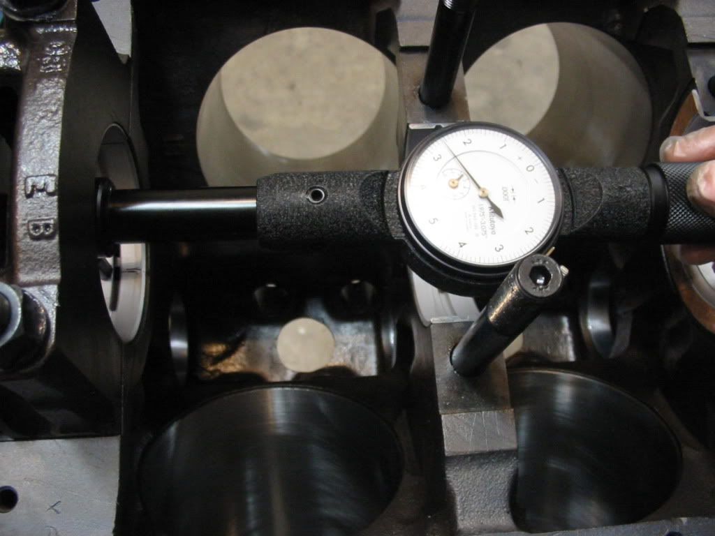

what kind of clearances you run on something like this?
lovehamr 04-17-2011 07:43 AM
Brent, glad you already have the rag in your hand for clean-up.........:eek:
blykins 04-17-2011 10:19 AM
Vector,
Somewhere between .002-.0025" on the rods....a little higher on the larger main journals like this one has. The mains on this one came in at around .0026-.0027.
Piston/wall clearances were at .006" per Diamond's spec.
Rod side clearance was between .020-.022".
http://i170.photobucket.com/albums/u...IMG_0033-2.jpg

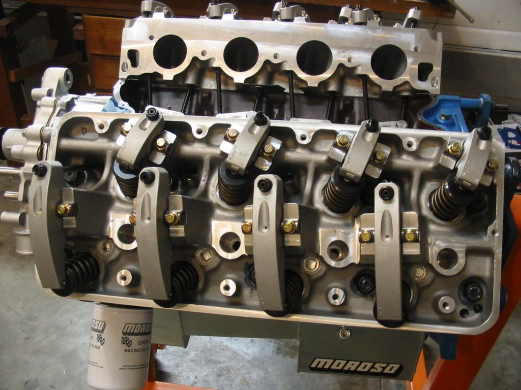

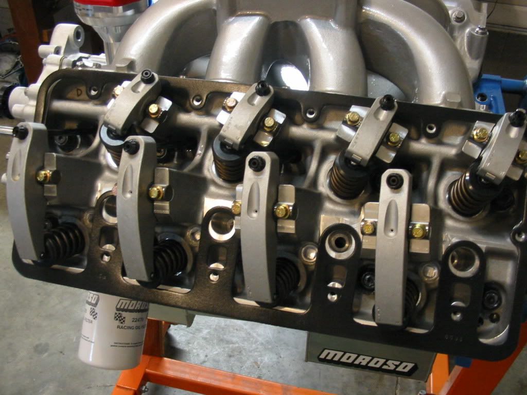

blykins 04-20-2011 01:33 PM
Ok more pics....
http://i170.photobucket.com/albums/u...r/IMG_0090.jpg
http://i170.photobucket.com/albums/u...r/IMG_0093.jpg
http://i170.photobucket.com/albums/u...IMG_0097-1.jpg
http://i170.photobucket.com/albums/u...r/IMG_0099.jpg
http://i170.photobucket.com/albums/u...r/IMG_0100.jpg
http://i170.photobucket.com/albums/u...IMG_0101-2.jpg
blykins 04-20-2011 01:40 PM
It's all slowly coming together...
Dyno day is post poned until the 29th, so we'll have to wait until next week to see the results.
All I have left to do now is to put the plugs in, cut the plug wires to length and terminate them, and put some baffles in the valve covers.
This engine has been one to test my patience....but that's why they call it engine "building" instead of just engine "assembling". Don't ever expect a part to fit right out of the box...
lovehamr 04-20-2011 06:07 PM

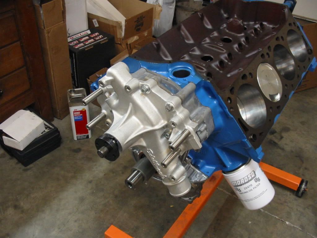

Brent, are those 4 machined alignment dowels for setting the timing cover and WP? That's pretty slick!
blykins 04-20-2011 06:08 PM
Actually, they are mounting studs for the accessories....part of a March serpentine system.

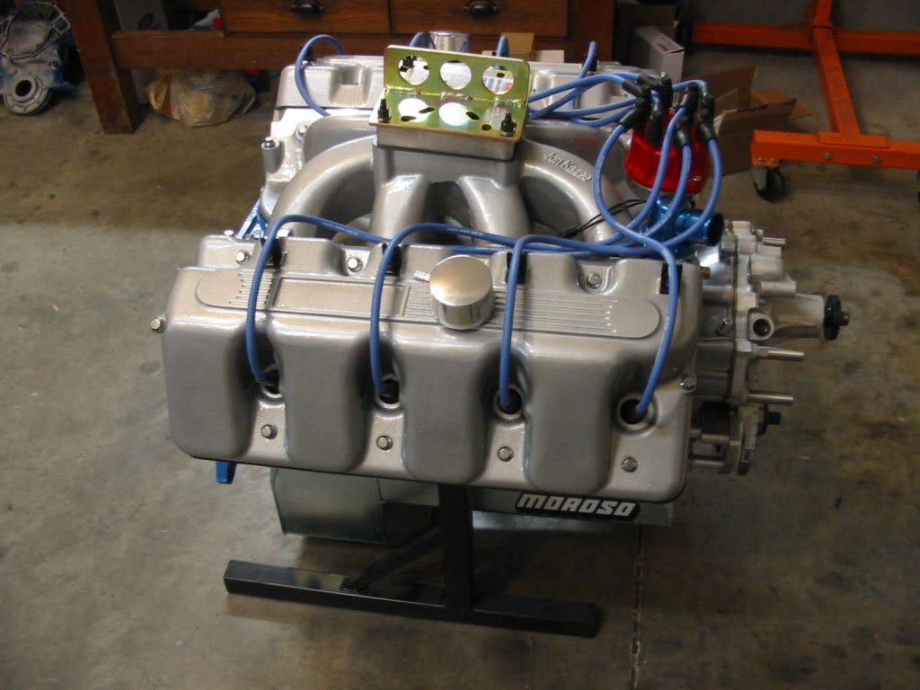

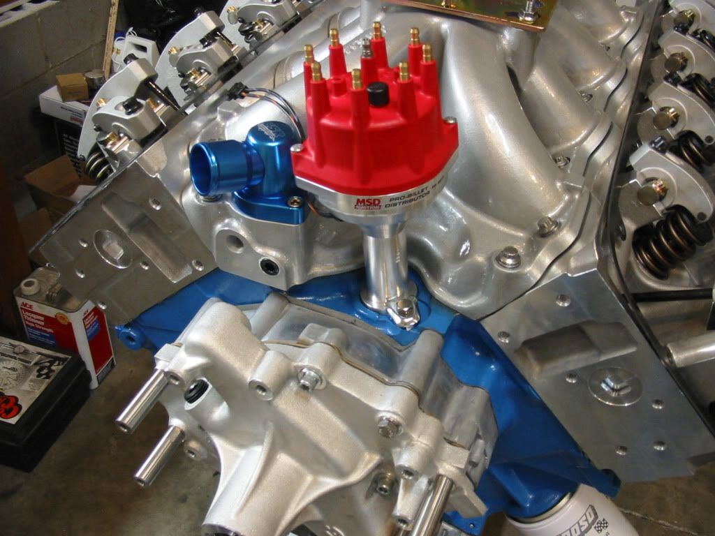

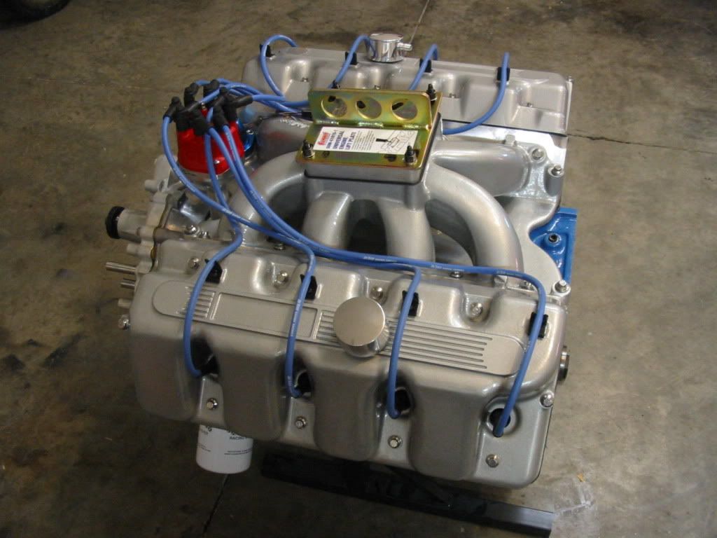

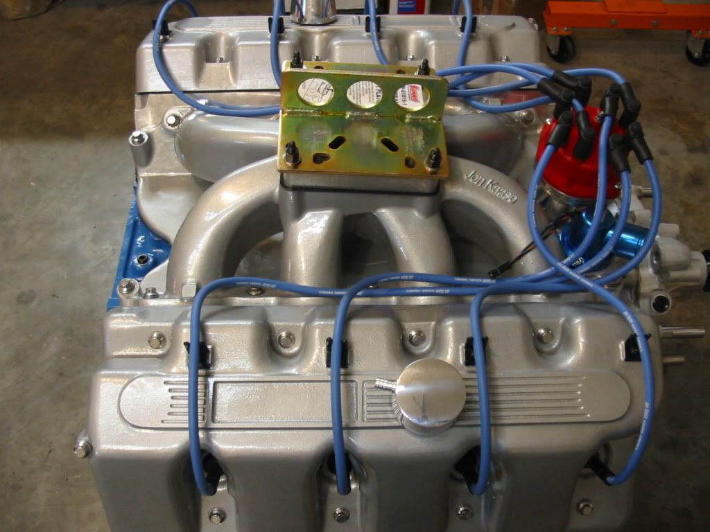

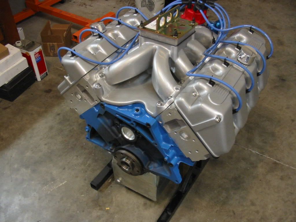

blykins 04-21-2011 03:03 PM
Ok, somebody stick a fork in it...
http://i170.photobucket.com/albums/u...IMG_0106-1.jpg
http://i170.photobucket.com/albums/u...IMG_0105-1.jpg
http://i170.photobucket.com/albums/u...r/IMG_0103.jpg
http://i170.photobucket.com/albums/u...r/IMG_0102.jpg
RodKnock 04-21-2011 03:10 PM
That's one beautiful engine.
Here's my input. Black spark plug wires. :o
Amazing too. The engine build only took 3 pages from start to finish. :LOL: :rolleyes:
blykins 04-21-2011 03:11 PM
Gotta go with what the customer wants....everyone has their own taste in accessories. ;)
