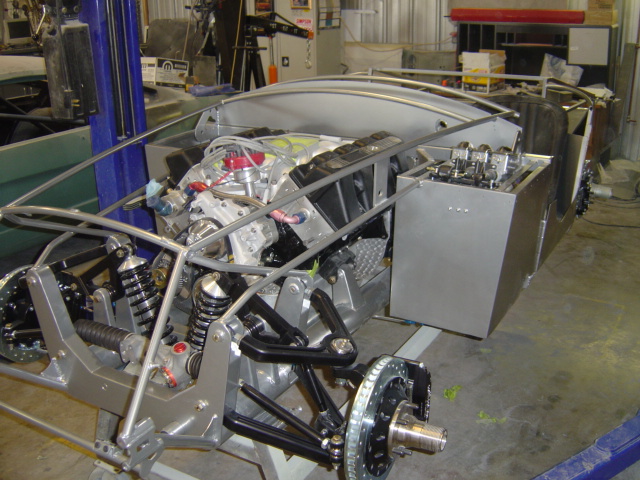

 I looked into this style engine for a customer last year.  Unless I had the wrong dimensions I was convinced it could fit in the hole with a custom hood scoop? |

 I'm not for sure Jay, I was always under the impression that if a Cammer was a tight fit that required footbox mods, hood mods, etc., that there was no way a Boss 9 engine would fit.  The 460 block is taller, although not by much.
 May be something to look into.
 This is an engine where it's possible to have your cake and eat it too.   Gobs and gobs and gobs of horsepower and torque, but completely streetable and mild mannered.

 If you have space problems for power brake booster with the taller block---think about using master cylinder and hyd booster from the late mustands--hyd from the power steering--much more compact and no vacume problems

 Jerry, I will advise the customer on that.  I can see where there would be clearance issues between the valve cover and the booster. |

 I looked at this once and going with floor mounted pedals like the CSX4000 cars and some other manufacturers now would eliminate the booster clearance issue but the motor is taller so you would need modified hood/scoop and of course with the wide motor and big heads how much foot box room would you need to give up. I beleive there was a post last fall that someone was actually putting a Boss 9 in a Cobra...

 It can be done with some foot box mod's and some repositioning of things.  A low profile air cleaner is a must if you don't want to modify the scoop. Aviaid makes a road race pan that sat 1/4" above the frame rail, so that works, but I was not crazy about the pan, so had a one built by Olson (much better).  Anyway, it has been done. |

					Originally Posted by BossCER  It can be done with some foot box mod's and some repositioning of things.  A low profile air cleaner is a must if you don't want to modify the scoop. Aviaid makes a road race pan that sat 1/4" above the frame rail, so that works, but I was not crazy about the pan, so had a one built by Olson (much better).  Anyway, it has been done. |
BossCER,post your pics,it ain't bragging if you did it
Lots of guys stuffing the 4.6 DOHC in Cobras and they are bigger physical dimensions than a Boss |

 Couple nice pics in his gallery...

					Originally Posted by blykins  Wow, just thinking about bolting headers on is making me sweat...LOL |  Being someone who has actually done that on a real B9 I have to ask if you/him know about the B9 shock towers?  If so, what is the plan?  Because that motor will not fit between those of a standard mustang.

 He and I have already discussed that part.
 Mark is actually having the Weavers (Unique Motorcars) finish this car for him.  It's getting an MII front suspension and a new rearend with coilovers.  Basically a make-over.  Part of the discussion involved replacing the shock towers.
 He's also having the same guy build his headers that Jon Kaase and Stacey David got to build theirs.  I think they are stepped, 1-7/8" to 2-1/4".
 Should be a nice ride...
