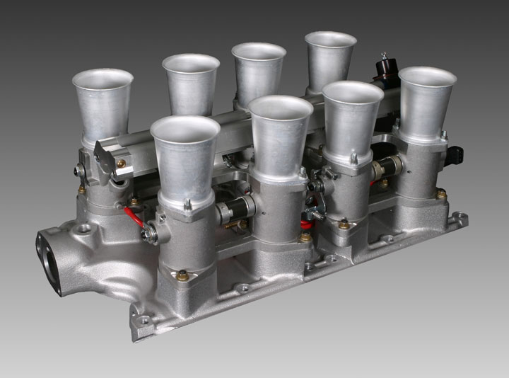

Default Your build is just begging for this setup with a proper EMS.
Best regards,
Richard Hudgins

You're killin me Richard. Besides I'm more of a modest guy. That thing would just be bragging. I'll stick with my plain jane carburated 600hp, red/silver stripes/black numbers type of daytona coupe. Much more modest.
Mat
