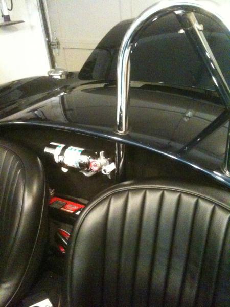

Here are a couple of other options for fire extinguisher mounting. I didn't want it in the way of my elbow or anything else I might want to temporarily put on the center console. Its not like there are many places to put things in the cockpit.....
The extinguisher is the 1.xlbs (forget the exact size, but is the small one) halon.
