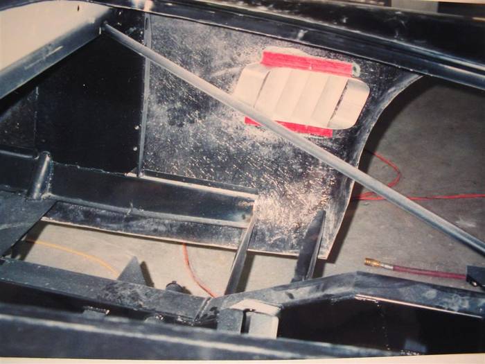

1. Screens on the front wheel wells kinda like those pictured above. That really helps keep the foot boxes cool.

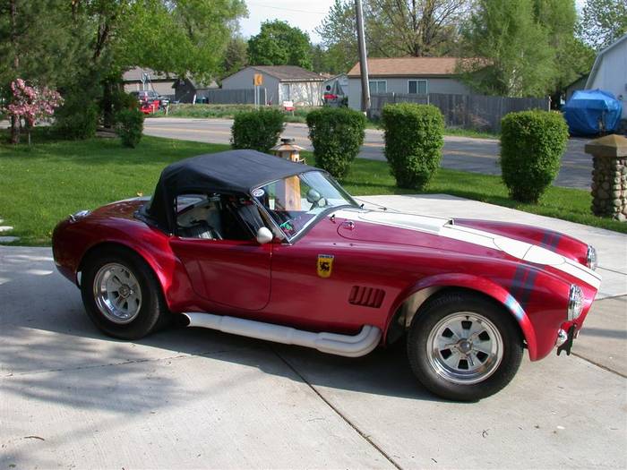

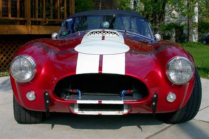

I can't leave anything alone - I've always got some crazy idea how I could "improve" my stuff....
I'll break these down to things I did during the build, and then things I modified later. I have added a bunch of pics to Gallery, so you can see some details and alternate views there.
For starters, I knew I was going to put a Cleveland in my FIA, and I knew I wanted it to breath through 427-style side pipes. Fortunately, I made about three trips to New Britain during the cars construction. Early on I determined that some frame mods would be required to accomdate my side pipes through the body:
The outer frame rail had to be cut back, and unique braces added.

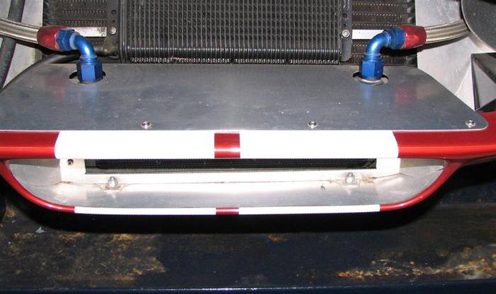

I planned to open track the car, so I took it to my old friend Stu Galbraith at Weldcraft Welding to have the tunnel brace modified, a forward leg added to the roll bar (I originally ordered the car from ERA with a 427-style rear-braced roll bar specified), and side impact braces (copied off Frannie Kress's Cobra) added in:
I'm pretty sure the finished product added a lot of stiffness, and it helps insure that I step high enough over the side braces that I clear the hot pipes, too.

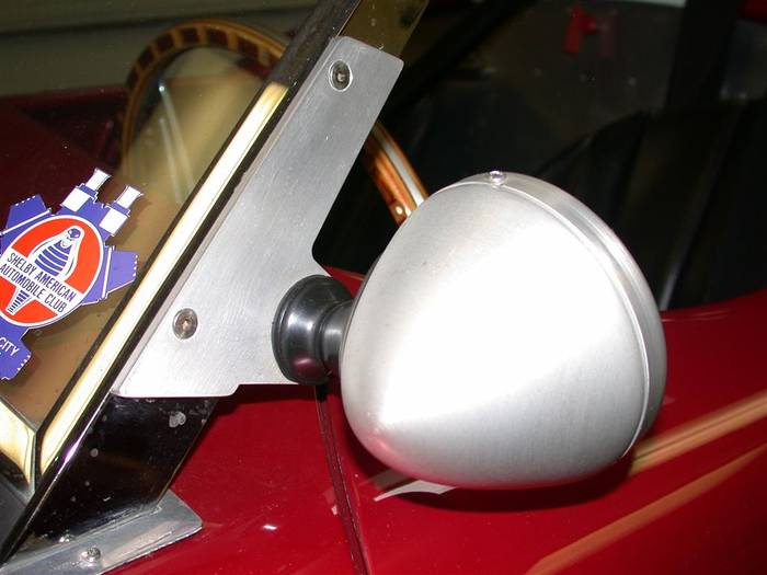

I also copied Fran's racing mirror mounts on the windscreen:
Since I used a rivet-on 427 style hood scoop (I liked the looks better than the FIA-unique scoop), I had to make my own scoop insert...
And I finished off the inside of the oil cooler scoop with aluminium, so the raw 'glass doesn't show up:

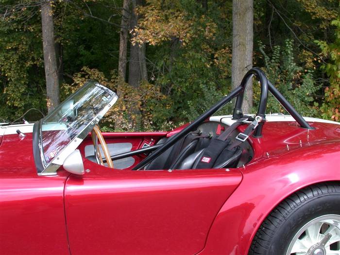

CobraJeff, your windshield appears to have a substantial amount of additional rake to it...is that just the photo?
Dwight...Maglight Flashlight? I bet you used it for the filler and cap?
As to the vent screen in the front wheel-wells...Could I have seen it on one of the CSX Fiberglass replica cars maybe?

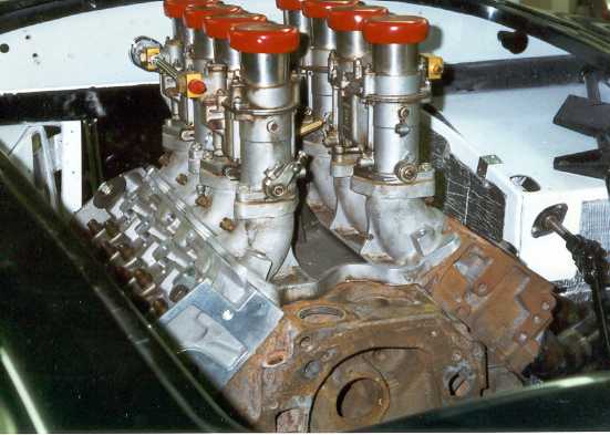

A lot of modifications to the original suspension were made, but the main custom touches were the valve covers and overflow tank.
For the valve covers, I machined up my own patterns and had aluminum castings made, then machined the raw castings for final fit and finish; two piece units w/no mounting flange - socket head cap screws bolt down through the side wall and then the top plate bolts down to seal everything up.
Ended up using the valve cover patterns one more time to cast up a set of covers for my 66 Mustang, so I recouped a little bit of effort, but I don't think I'll ever try something like this again. The Ford logo was probably the most difficult part to make; drew out the logo on a sheet of rubber that was glued to a block of wood and cut it out with a razor knife, then sandblasted the wood and bandsawed out the logo... little cleanup work to the piece then had it cast in aluminum and worked the heck out of that to get the final pattern.
Too much like work, and if I wanted to work I would get a real job
For the tank, I bought a standard big block overflow tank from Dove and cut the bottom off, then machined up a new small block thermostat cover and welded it all back together.
All I really wanted to do was kinda replicate the look of the air cleaner cover, but stupidity takes real committment!

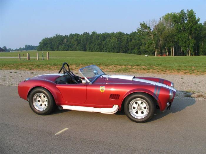

Hyde and Blas -
IIRC (it was over 12 years ago), I think that I slotted the holes in the windshield frame a bit more to get some extra "rake" to the windshiled.
That did, however, present some problems when I went to install my convertible top. I had to cut and modify the top bows to get the top to fit with the raked windshield.

I sectioned the foot-boxes in order to make room for the 351C:
I think I took nearly two inches out on each side, so that I had room for the headers.

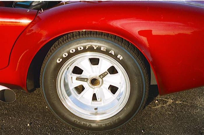

Then there were wheels - I ordered my FIA style Halibrands from Phil Schmidt - two 8.0" for the front, two 10.0" for the rear, and one 5.0" for the spare.
I painted in the GoodYear lettering on all of the tires, and painted on a blue stripe to make them look like BlueStreaks. The lettering and painted stripes held up pretty good, but, since I never got around to a front end alignment, I tore up the front tires in less than 1,000 miles (the rear ones were suffering from lead-foot-itis, I think). The Gatorbacks were hard as rocks, and didn't provide much traction. I replaced them with BFG Euro T/A's, and was able to increase the tire size significantly - going from 225/60x15 on front to 265/50x15, and the rear from 255/60x15 to 305/50x15.

Jeff - thanks for the compliment, was happy with the outcome (other than the weight - they are HEAVY!)
Here are the semi-finished covers before the engine went in... was thinking about going with a black krinkle finish but went with plain grey (should have done the black...)
Also was fooling around with a gates-style belt system but couldn't get the courage to try it out in the real world - thought it would be too much weight on the water pump and alternator bushings (still have the pulleys we made stored in a box though, so maybe one day... or remake from aluminum instead of steel blanks).
