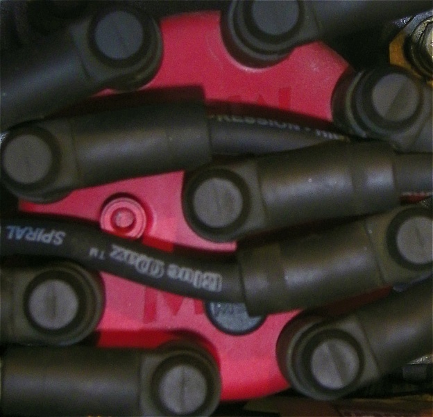

Posts: 22,025
Originally Posted by Zoom This View Post
My center electrode carbon ball was left sitting directly on top of the rotor tang when I removed the distributor cap during a tune up a few years back. I called MSD to air my complaint and they sent me a new cap. I have been a little cautious about this happening again but all "seems" to be OK. It is hard to understand this ongoing quality control issue by MSD however.
Did your original cap have the little black venty looking thing you see below?
