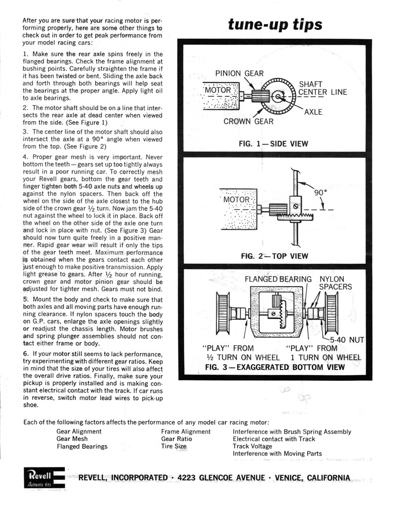

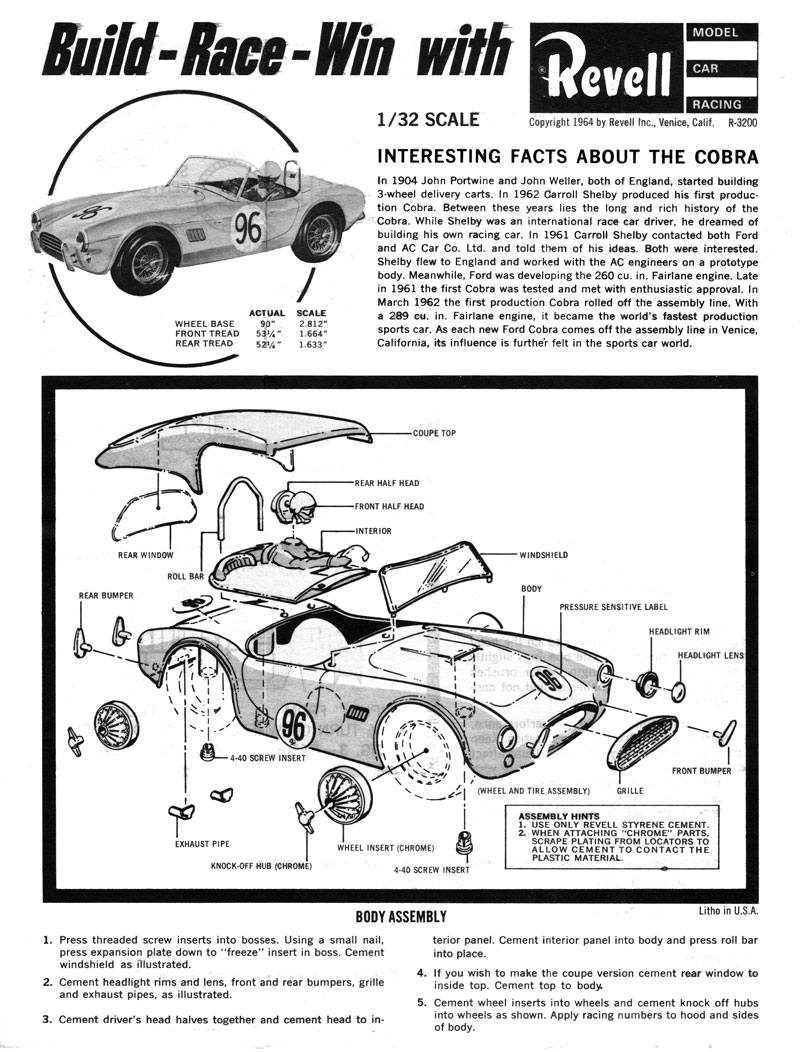

Really, our Cobras today are no different, other than the price, from the one I had in 1964:
http://www.clubcobra.com/photopost/data/500/revell.jpg
http://www.clubcobra.com/photopost/data/500/revell2.jpg

strictlypersonl 05-05-2010 07:33 AM
I wonder if Revell would mind if I used their sheet for my new assembly manual. ;)
Although their "history" needs a little editing for accuracy...
patrickt 05-05-2010 07:36 AM
Aww, dang... I had already planned on posting that the next time somebody had a question on the ERA Jag rear.:LOL:
elmariachi 05-05-2010 07:40 AM
Just looking at that assembly diagram, I can see now see where I went wrong. I didn't cement the driver's head halves together.:LOL:
