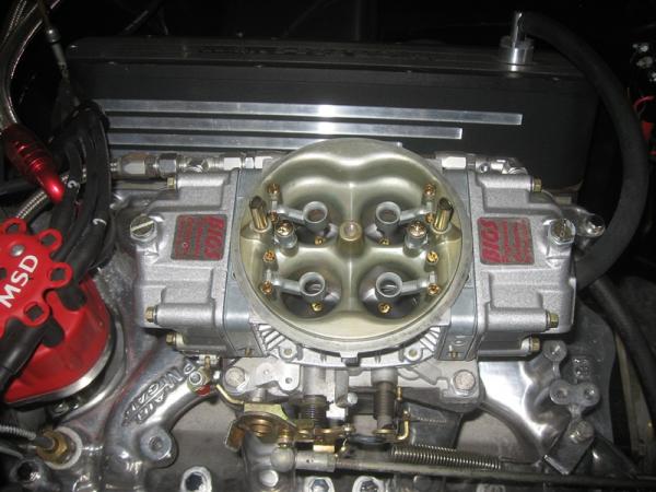

I've got a Bigs Stage 5 Double Pumper 750 CFM. No choke, no problems. I think the key is when you buy the carb, you tell them what kind of engine and they set it up to run out of the box.
