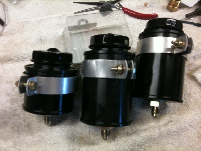

I used PVC glue cans purchased at Home Depot. The Girling lids will screw onto them.
I bought the new cans to replace my original two large Girling cans. One of those original cans was dual function with dual lines. I prefer the look of the triple small cans.
You can strip the paint off your existing cans and have them powder coated.

To prevent the fluid from slopping out of the cap get 2 or 3 of these rubber accordian looking parts from almost any Autoparts store to put inside the Girling cap. It will prevent the fluid from getting out and eating your paint. Actually I prefer Silicone so I don't have paint remover issues. Also someone had a good point not filling them up so full.
All of these have a perfect fit inside the Girling metal caps.
HELP! Part No. 42072
42072 Dorman Master Cylinder Gasket, Autozone $5.99, O'reilly, $6.99
42072 Motormite Brake Master Cylinder Reservoir Gasket, Advanced Auto, $6.39
BK 6751210, Brake Master Cylinder Gasket, NAPA brand Balkamp, $7.99
I guess the Kirkham billet can is ok if you like bling I prefer the the cans that come with the Carbon Cars from Exact. You can be billet and have a very original appearance at the same time. It all depends on your taste I suppose.
