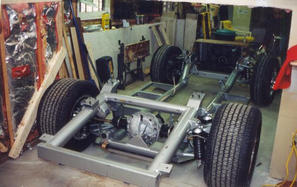

Anyone willing to show the 8.8 Ind. (Either lincoln or Cougar) in a raw frame?

Posts: 1,735
Check it out
Fasterpatricks Custom Cobra
6th generation Texan....
Old 07-03-2010, 05:47 PM
Double Venom's Avatar
Location: Pentwater, Mi
Posts: 5,352
Amazing.
Thanks for the link.
DV

I made an album in my profile. If you go there I have two good pics that give you a good idea of how EM did it. If you look close you can see where the lower control arms are on adjustable cams for alingment work.
http://www.clubcobra.com/forums/pict...pictureid=3710
http://www.clubcobra.com/forums/pict...pictureid=3709
Well I got links to the pics here if not the pics themselves

That is a great looking suspension that ought to have superb reliability and durability.
