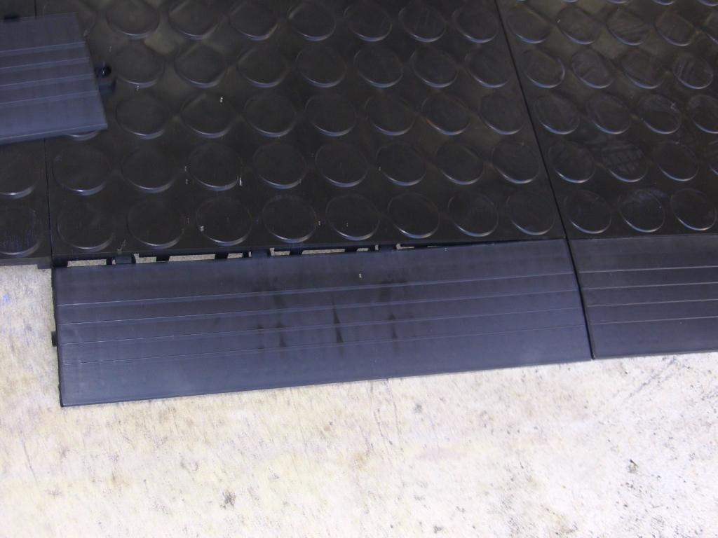

Didn't take to many pictures during the install, except to provide a hint that at least worked for me.
If you look at the next series of four pictures, you will notice that when fitting a piece into a corner, I set the corner first, then worked my way out to the edges. I found that if I started at the edge, it was extremely difficult to fit the corner, as it was kind of wedged in.
http://www.clubcobra.com/photopost/d.../PIC_0049a.JPG
http://www.clubcobra.com/photopost/d.../PIC_0050a.JPG
http://www.clubcobra.com/photopost/d.../PIC_0051a.JPG
http://www.clubcobra.com/photopost/d.../PIC_0052a.JPG
For the transition pieces in the first two pictures above, I used a rubber dead blow hammer to set them in place. I also used the dead blow hammer for the pieces I had to cut to fit around the edges. For all the other, like in the second two pictures above, I just stepped on them with my foot. Once again, I worked the corner first.

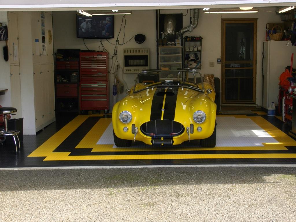

And here it is, all complete. Yes, I know, it's still a mess, but it's also a working garage.
http://www.clubcobra.com/photopost/d.../PIC_0054a.JPG
Finished with the car in place.
http://www.clubcobra.com/photopost/d.../PIC_0055a.JPG
