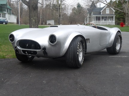

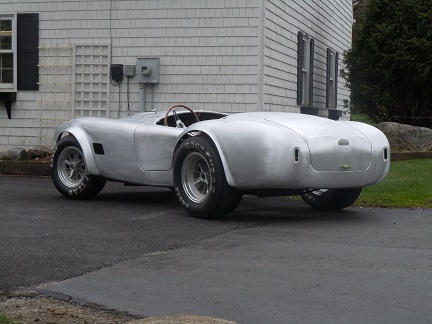

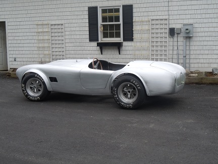

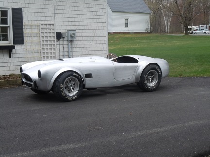

This car was built entirely by hand using traditional metal shaping techniques employed by English Panelbeaters. The intent is to build a high quality replica to exacting standards using only the above mentioned techniques. The alloy used in construction is 1100-0 and 1100 H-14 16ga. The seams are all welded using an oxy/hydrogen flame.
