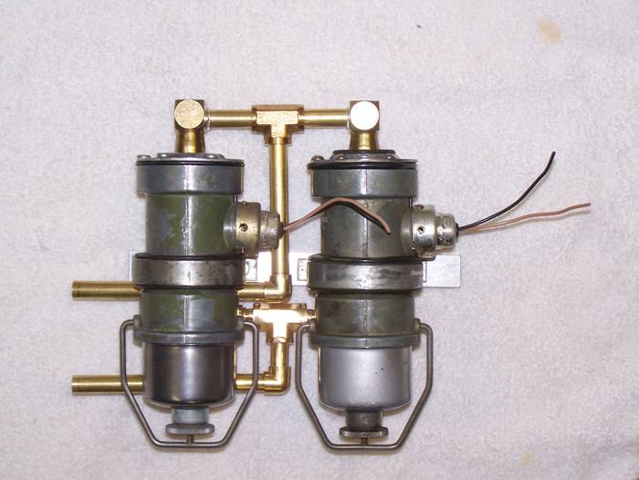

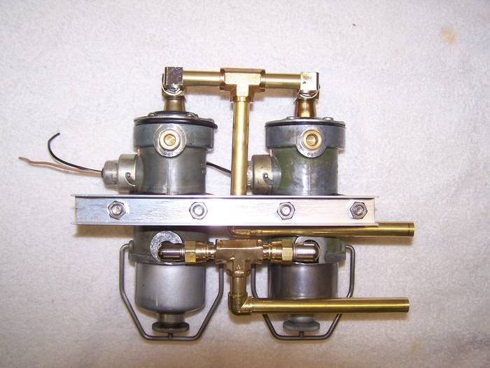

Love the look of those old Stewart Warner 240-A fuel pumps from the 60's. Bought a few on e-bay over the years with the thought of rebuilding them. Even with the available parts on-line and the excellent instructions on the GT40 forum, the pumps I bought were beyond rebuilding, mostly due to bad corrosion.
I really wanted to mount a pair in my trunk, even for "show", then I got thinking. So with a little on-line research and some inventing, I got an idea.
I gutted a couple of the pumps and mounted a modern inline electric fuel pump inside and fashioned some prototype "plumbing" and voila - see pics.
I'll nickel plate the top and bottom pieces, paint the body the right color (?) and do the plumbing in stainless.
The result should be two working, modern inside, vintage looking outside, pumps.
Now that is anal !!!!!!!

Next week I'll get the stainless lines done (so it won't look like home plumbing), get the bodies cleaned and painted and send the bits and pieces out for nickel plating. I'm using 1/2" ss lines to plumb it and this may be overkill (3/8" would probably do) but I figured a little more volume to my 2 -4bbl manifold won't hurt.
These electric pumps put out 30 gph and 5 - 9 psi each (the original SW pumps put out 60 gpm and 8psiadjustable down to 4psi), so they should be adequate for performance driving but maybe not enough for any all out competition.
Although when the racing Shelby Cobras had two in the trunk, only one was used at a time. One used when racing on a full tank and the second switched on when the tank was low to catch the fuel as it sloshed around.
I'll be using a regulator and return fuel line and I'm drawing from the tank througha Russell billet in line fuel filter (40 micron).
Actually both were used at the same time.
The Comp cars had a mechanical pump for normal fuel flow, and the S-Ws were turned on to pump the reserve.

Thanks for all the positive comments guys. I wasn't thinking in my earlier post when I said I would paint the bodies. What I should have said is I was going to clean them and alodine 1201 them (aircraft alodine) and restore them back to their original golden color. I'll try to match the color to a pair of original (untouched, not used,NOS) pumps I have.
I'm going to test mount them in my trunk and post a pic.
Greg

Any photos of how you secured the new pumps inside the old housings?

Hey Wolf K. Are you trying to steal my secrets??????
Just kidding. I'll take some pics tomorrow morning.
