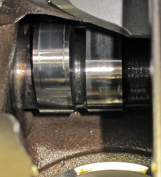

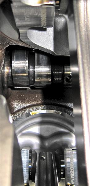

I really need some expert advice here. The issue is a scored cam lobe.
In replacing a leaking oil pan gasket, I decided to look around a bit and found the pictures attached. Two witness mark grooves on the cam lobe, in at middle of the motor. Does this look like a roller failure or about to be a roller failure. I could really use some experienced advice here.

blykins 09-26-2011 01:03 PM
What kind of cam is it? Solid or hydraulic? Kinda looks like a cast core cam that's been run with a lot of spring pressure.
Gaz64 09-26-2011 01:03 PM
Wayne,
Unfortunately, looking at your pics you have a skidding roller.
As soon as the roller doesn't roll for some reason ( bearing failure or case hardening of the roller ), the roller skids and cam lobe failure is the result.
Pull the lifter out, have a look at the roller.
I'd say your up for a new cam and lifters.
blykins 09-26-2011 01:07 PM
Good point Gary.....maybe a lifter has already failed.
Wayne, can you feel a lip on the other lobes?

The rest of the lobes, as far as I can see and reach from the bottom, look OK and feel OK. The burned looking area on the cam shaft, next to the scored lobe also got my attention.
This is a 4,000 mile motor that runs great and not a sound coming from the internals. I guess that could be the case right up until it breaks something and breaks something and on and on.
I'm new to little Ford street motors but I guess I'm in for pulling the intake and having a look.
At any rate, new cam and components, right? Anything else to look for or does this just look like an isolated roller failure/almost failure?
I guess the good news is that I was replacing a weeping timing cover gasket as well...and it's currently off too. I guess the blessings are where you find them.
Brent, I'll need some discussion on what to put back in there and get the parts. Might as well go as nasty as possible while I'm at it.
blykins 09-26-2011 03:11 PM
If you can't feel any wear on the other lobes, then I'd say Gary hit the nail on the head. It's possible a lifter had locked up and was sliding. You would think that if it were a spring pressure issue or something like that, that the rest of the lobes would show signs of wear.

The pictures are a little deceiving I think. The twin "marks" are scores that can barely be felt cutting into the lobe with a finger nail. No metal appears to be lost between the marks.
I have a magnetic drain plug in the pan and it was clean/no metal. I did cut the oil filter open to have a look and again nothing in there either. Could be ultra fine stuff that couldn't see by washing the filter material out, but nothing big enough to see or feel.
I'm going to post more pictures as I go because you guys are good and this is really helpful. At the moment I'm thinking I'll just replace the cam and lifters.....and discuss the pushrods and rockers as I get to them and see what they are and how they look. The motor was supposed to be built all the "right stuff" at a big cost number. So we will see.

Gaz64 09-28-2011 12:48 AM
Wayne,
Have you inspected the roller?
Can you post pics of the lifter roller?
We can see the overheated blueing on the shaft which extends further away from the lobe on the base circle compared to the nose.
It shows the amount of friction the failed roller has caused.
You may not be able to feel it with your fingernail, but it is there, it is an abnormal wear pattern, and it would have become a catastrophic failure.
The ground up metal, as small as it is, would have passed through the oil pump first before the oil filter traps it.
Inspect your oil pump as well.
Rick Parker 09-28-2011 09:03 AM
There is definate bluing as mentioned near the visable lobe, however it is unclear if it is confined to only this lobe OR if it is indicative of the hardening for each lobe during the manufacturing process?? IMO if the roller had frozen there would be more significant metal tranfer. There is no doubt a problem with the lifter but it appears to be at the initial stage of failure. JMO
joyridin' 09-29-2011 03:24 PM
I'm by no means an expert, but it looks like a soft lobe to me. The last 2 times I saw a roller seize, the cam was a pretty nice shade of blue. This has no heat marks.
Just my 2 cents.
concobra 09-29-2011 05:45 PM
Hello wroger55
My 2 cents worth
I don't think the problem is all that bad. I have ran rollers for ten years plus and seen this kind of pattern on many good lobes. As long as it is not diggin into the lobe I have not had a problem. It may be just the lifter spinning on the lobe. And a normal wear pattern.
As far as the blueing. My experience is if the roller stops spinning it will tear up the lobe extremely fast and you will maybe see some blueing on the lobe itself. But more than likely the gouging of the hardened roller grinds through the heat bluing faster than the blueing can remain on the lobe. I don't see any signs of that. I believe the discoloration between the lobes is due to the heat treating billet roller cams get to harden the lobes. The dark color beside the lobe, not on it, could just be the copper discoloring during the heat treating operation when the cam core is made. Copper is used on the core of the cam to keep it from hardening as hard as the lobe does to keep the shaft from becoming brittle. I have bought many new cams with this coloring issue here defined as bluing already there.
Hey I could be wrong here. But testing the roller is certainly called for. One note of importance. If you do test your lifter DO NOT clean it in any solvent. Leave the oil on it, it was running in. IF you have to take the rollers out of your engine. Place them in the cleanest container you can and pour oil over them completely then cover the container.
