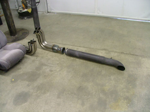

Originally Posted by lamaluv View Post
My O2 sensor is located where the collector and side pipes meet. I am running a FAST EZ system and have not had any O2 sensing problems in the 5 years I have had it on the car.
lamaluv, if I'm seeing the picture correctly, you have the sensor angled downwards, which is contrary to the recommendation to have it angled upwards (in order to avoid condensation getting on the sensor). Yet you've had no issues in 5 years. Cool.

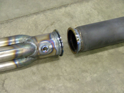

The picture of the sensor on the car is deceptive as the wiring from the sensor hangs down making it look like it is angled down. It is actually tipped up which is shown better in this picture. The hole is just above center on the collector pipe.
OK, I see. Thanks much.
