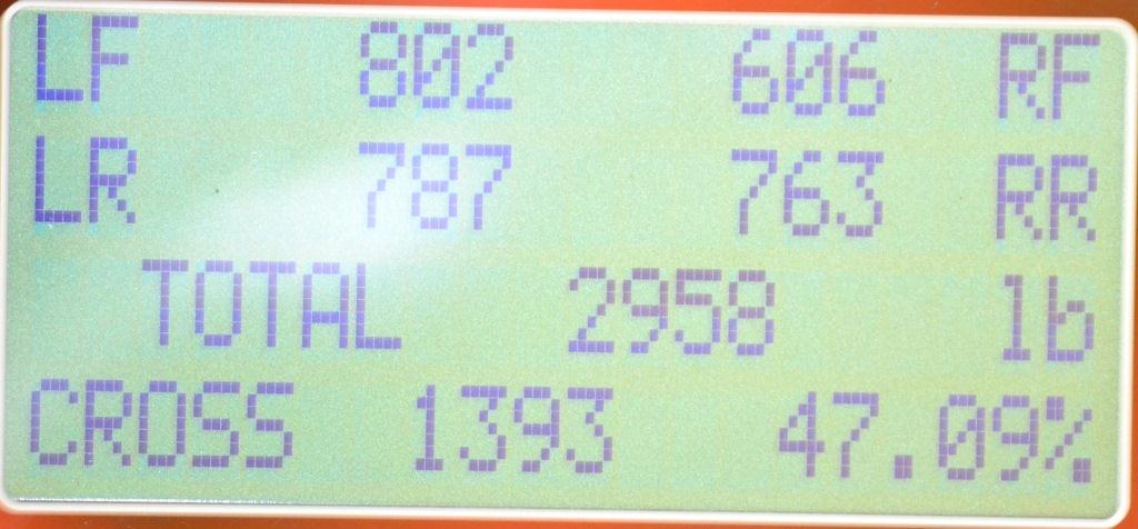

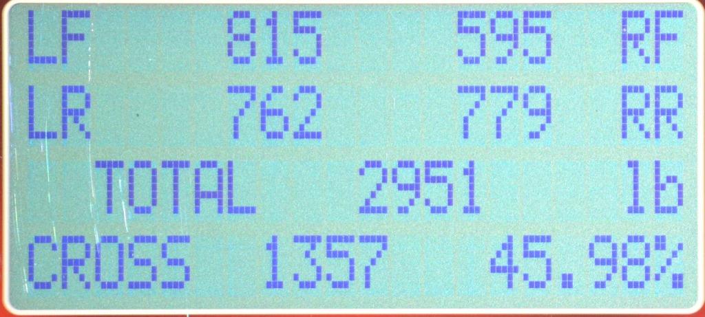

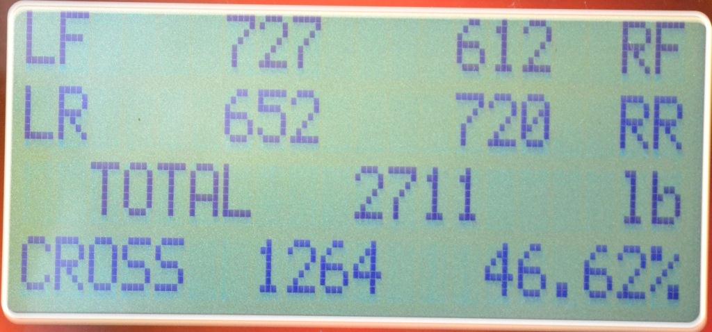

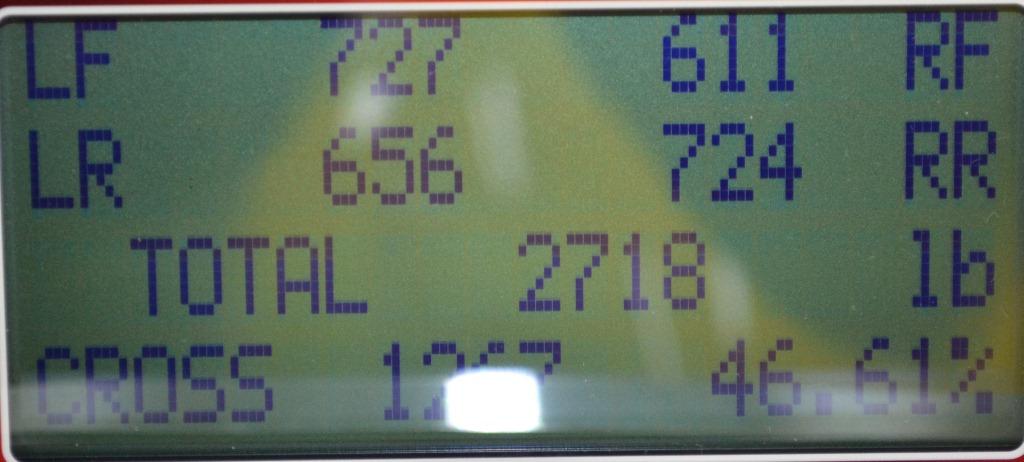

First picture is just rolling the car on the scales.
Now with my fat butt in it.
This was just to get me an idea of what I had.
I then disconnected the sway bars.
Once again, just the car.
And then with me in it again.
John Hall
