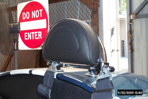

This one looked slick:
Headrest

While I agree it offers better protection, I was looking to keep the bar as open and unencumbered as possible. And yes I will be cleaning up the bolt/nut on the rear bar.

Looks *****in! This is what I came up for my Contemporary! Dosen't look that great but niether will my head if it hits the roll bar.

That looks more like a headreast, but it looks safe.
