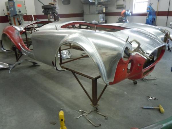

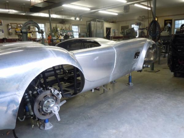

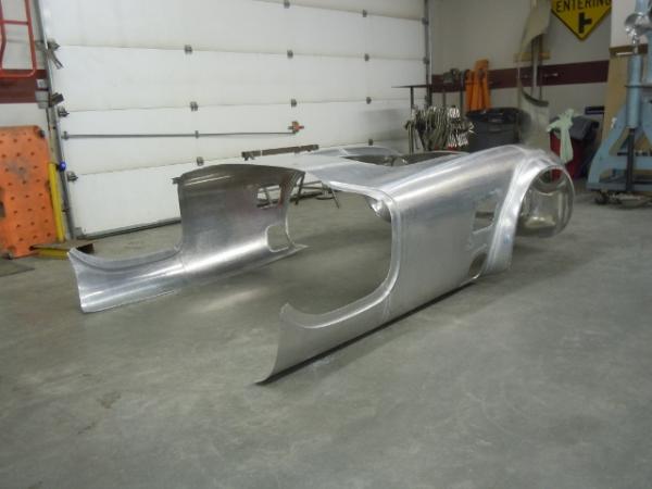

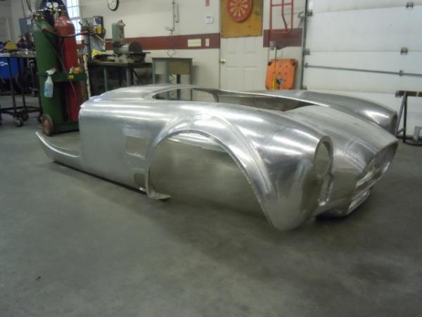

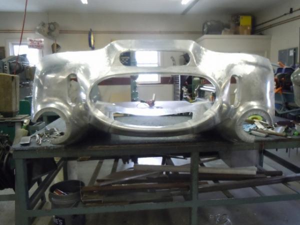

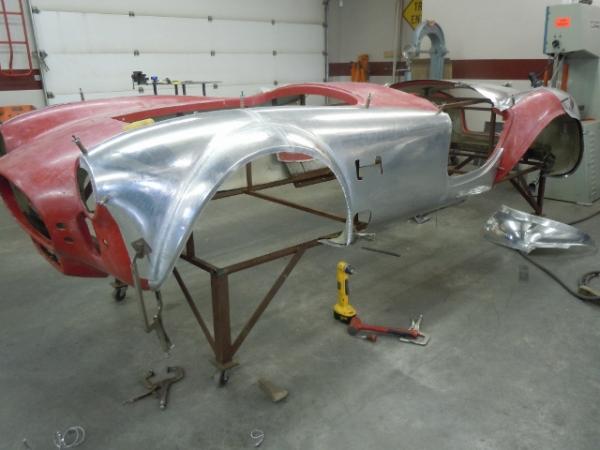

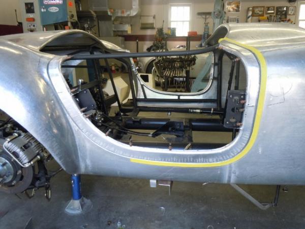

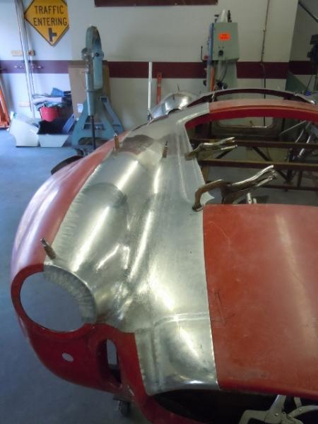

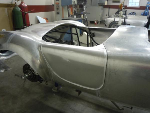

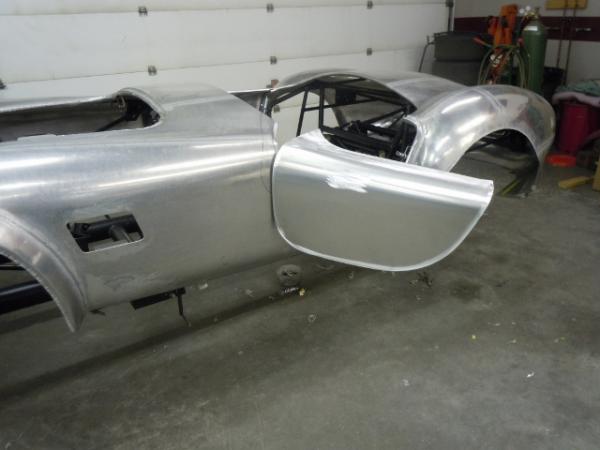

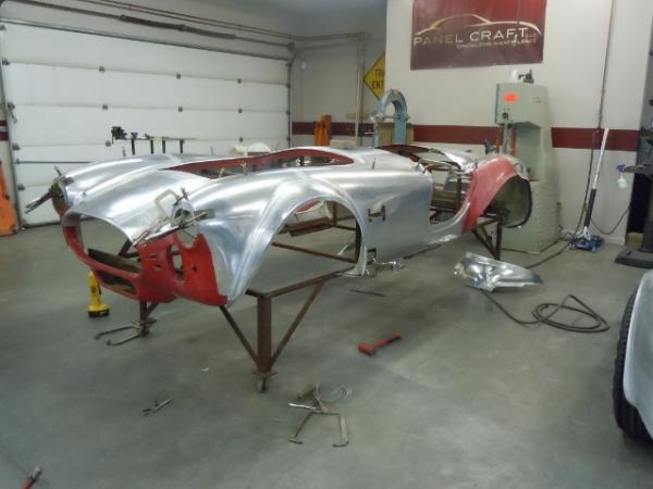

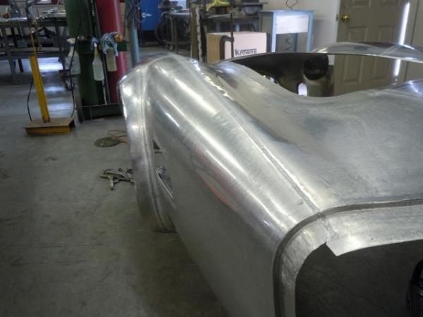

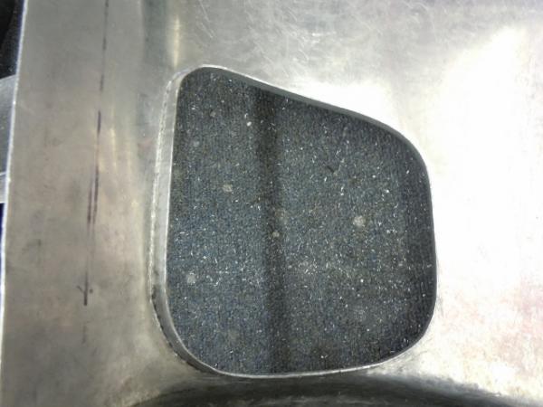

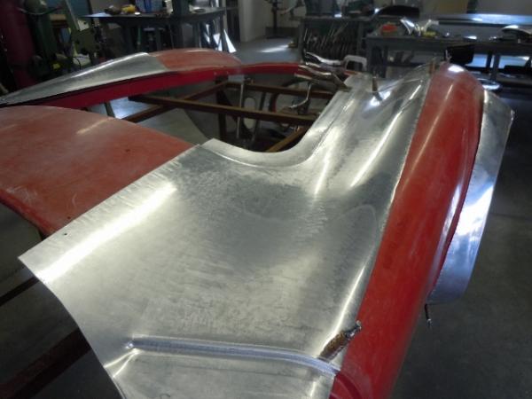

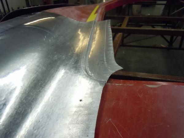

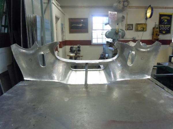

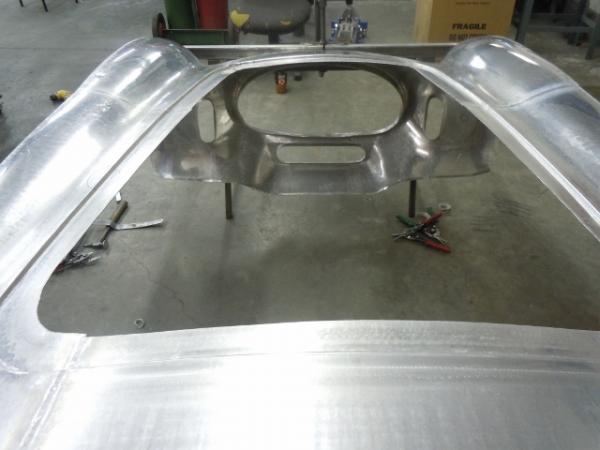

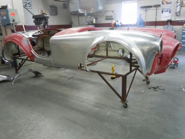

Early last week, saw the completion of 90% of Wheeling Operations. Since then I've welded the lower portion of nose cone including oil cooler enclosure, stepped in the gutters on upper portion of nose clip and welded those pieces together to form a shroud. Today I began welding the outer portion of right front fender and rocker panel. Sometime next week I should have entire front clip welded together and planished.

These pictures do not even come close to how good it looks in person Joe is like Picasso with metal he truly makes it an art form. All hail the "METAL MASTER "

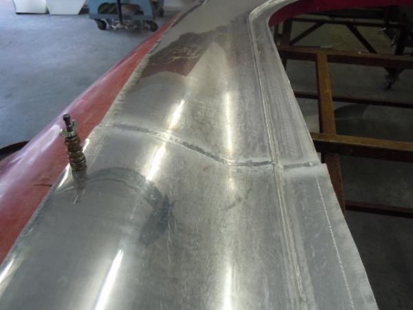

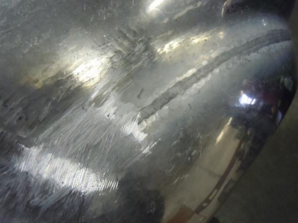

Thanks Joe for the pics. Makes me want to beat some metal. Is this torch welded and the seams planished till the welds blend and little to no filling when done?

All of the seams are Oxy/Hydrogen welded and then hand planished.
The CSX owner wants the aluminum body, to my knowledge there was no damage to the original fiberglass body.

Joe any chance of a closeup of a weld before and after planishing? Also on my previous post I meant filing not filling. Mark

The welds need to be filed in order for them to blend into the surrounding base material.I like to file and then sand with an eighty grit pad in order to prepare for bodywork. In regard to the method of finish, it's my understanding that the car will be painted.
