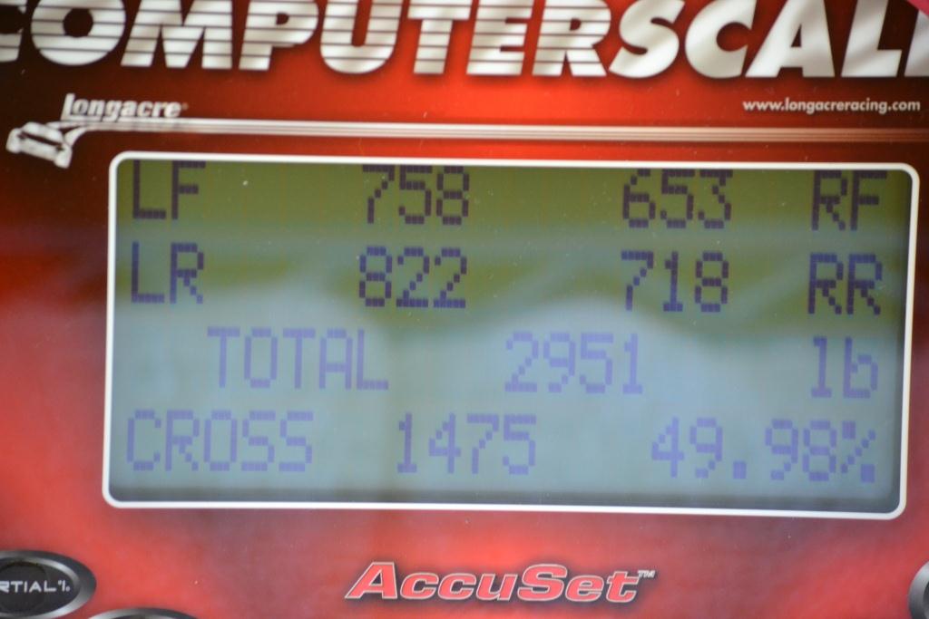

Here is my car after I did the corner weighing. It's a Superformance with a 385 series (460) in it. I weigh in the 240 range and you can see that the F/R balance is 47.8 / 52.2.
Not nose heavy by any means.
John Hall
Alright, it's yogurt for you for the rest of the summer. What was your final verdict on the corner weighting? Could you tell a difference in just normal, around town, type driving? Not autocrossing or racing, just regular stuff.

Well Patrick, our weather here in the not so great northwest has sucked big time. Cold and wet for the most part, with 3 of the first 7 days setting records for rainfall.
I put my wife on a plane this morning for Houston, so I'm hoping that tomorrow will be nice enough that I can take it out and be by myself so I can push it a little.
