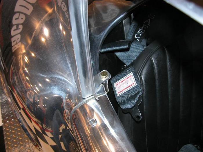

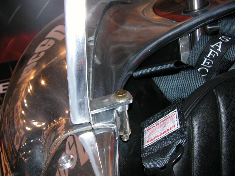

Of course I couldn't find the ones I had saved but I did find these on a Kirkham.
The part you can't see has a tab that runs back on top of the top lip.

I also ran across this windshield latch, though I personally like Nicks mount better. Just another idea.
