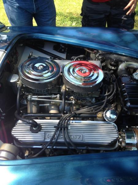

http://www.clubcobra.com/forums/pict...pictureid=9613
Have you thought about locating a 65/66 427 FE/SO block and building up from there? Oil management and temp are much better in the SOs than the COs/strokers and are strong running engines depending on set up. I am running mine with a moderate cam with twin quads on a high rise. good maintenance, oils changes every 1500mi (Royal Purple), etc is important also.
