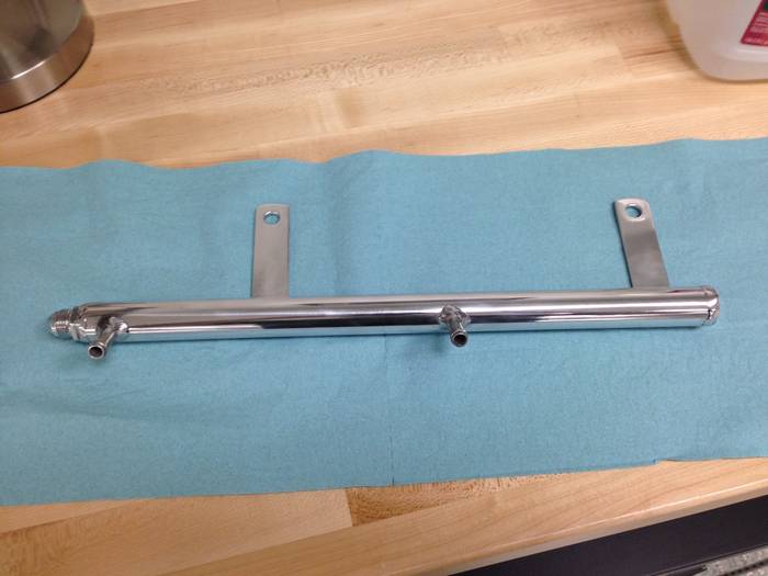

Of all the parts in my Cobra, probably the only actual Ford part was my 2x4 fuel log, and I'm not a huge fan of it to boot. I called Gessford to order one of those shiney ally numbers but they don't make them for non Gessford builds. Fair enough....but he did tell me where to get the parts!
We have a small, old fashioned machine shop at work with no way of welding aluminum. So I bought them a tig welder and went to work. I hadn't welding anything since high school. My HS had a pretty decent metal shop. We brazed, had spot welders, oxy-acetalene, arc welding and even heliarc (Mr. Johnson never called it tig).
I regulate 5 psi of fuel from a Holley black (14 psi). I figured if the regulator tore (which it had, recently), I should have double the psi as a safety factor, so I tested the log for 30 psi. It failed at a weld so I repaired the leak and polished away. The welds aren't perfect or very 'professional' but I'm happy with it. I welded an Earl's 8AN boss to the rear of the log (since I have an electric pump) and capped the front. I can always tap it later for a gauge. I didn't have much luck with the old gauge at operating temps, so there isn't one for now. I also extended the legs 1". I know I could have welded 6AN fittings to the dual fuel feeds but I'm going part old school, part new. When I get it mounted I'll post a pic.

Old 06-10-2013, 12:16 PM
Posts: 22,025
I think it looks great. Nice job.

Thanks, pt. Hopefully it'll look even better installed.
But the installation will mean a new regulator, fittings, braided line from the pump, etc. All good improvements but I may wait for rainy season.
rodneym

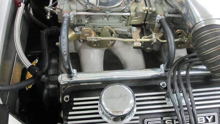

I finally got the fuel log installed last night and also made a new braided line with fittings. Now that I can make braided lines the perfect length the first time, I probably won't need to make one again until I forget!
[IMG][/IMG]
BTW, I got the rubber fuel line (off the log, to the carb) to not crimp. I put a piece of Stainless Steel spring inside of the 3/8" line, keeping it from collapsing. Now the effective inner diameter is roughly 5/16". The coil probably isn't good for the best flow BUT wouldn't you say it's better than crimping? Thoughts?
I had the same problem, but if you buy higher quality fuel hose, it shouldn't crimp. I found this Goodyear hose works better than some of the others and the radius from my fuel lot to my carb is a lot worse than yours......to fix it though I'd have to cut the brackets off and re-braze them, wrecking the coating, etc and I don't really want to do that.

dcdoug,
Do you consider Goodyear fuel line better than Gates? I always heard Gates was better. The previous Gates hose, being at the end/core of the roll, had a pretty tight radius but over time it would still crimp a bit

I would guess that after repeated heat cycles your hoses will eventually take a set, thus allowing removal of the springs and no worries of kinked hoses. Then you'll get that 1/16" back and the full flow will allow you to keep up with me.
