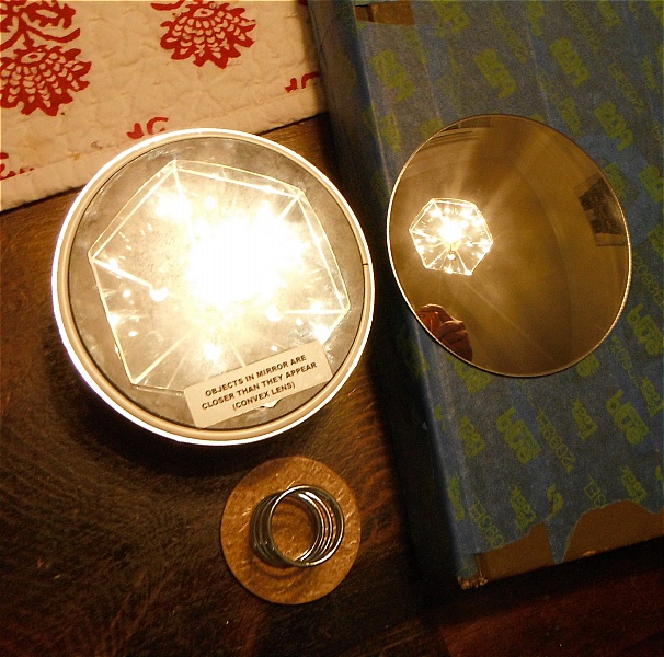

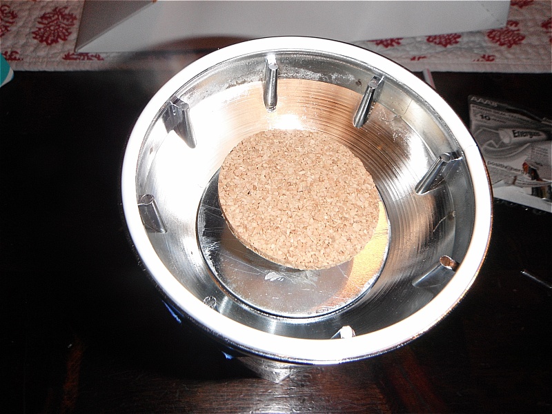

It sure is. Aardvark charged me $40. In the meantime, I'm using dental floss to compress the cork and spring so I can silicone the mirror and gasket in. Once that's dry, I'll release the floss from the back hole of the housing and the spring will uncoil and the cork will push out against the mirror reducing vibration. Here are two pics. Chas will love the fact that I'm using dental floss in this project.

Glass and chrome cleaned. I'll let the silicone cure one more night before I untie the floss, thus releasing the internal spring and cork. BTW, the gasket, spring, and cork look like they could be fabbed pretty easily from Home Depot components instead of spending $25 on them.

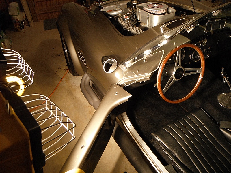

I trimmed the straw to pass around the screw that extrudes from the back of the housing so that the three pieces of floss, which are looped around the top of the spring in 120 degree increments, pass inside the straw, along the screw, and are constricted at the top by the straw so that there is a nice, even "draw down" of the spring. I then wrapped the floss several times around the base of the screw, where it exits from the straw, and put a little blue tape to hold it. The batteries are for a small flashlight, off camera. You couldn't figure that out?

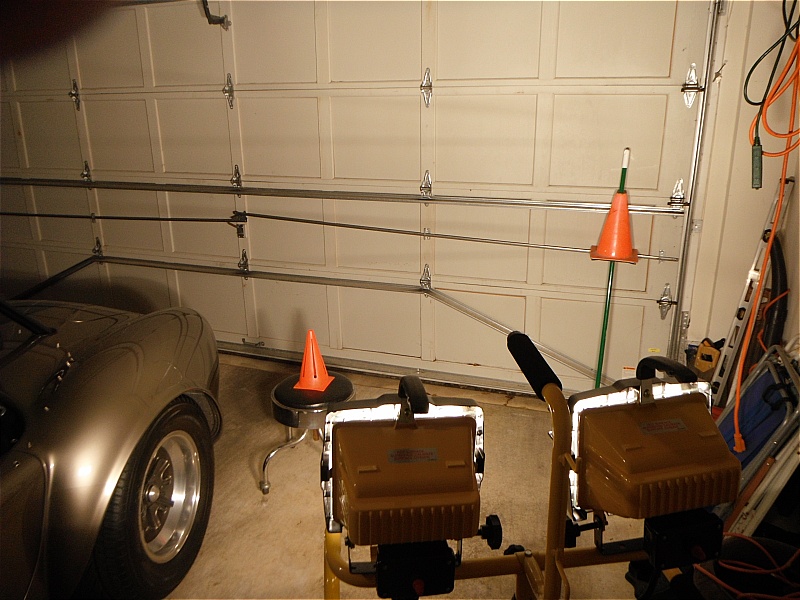

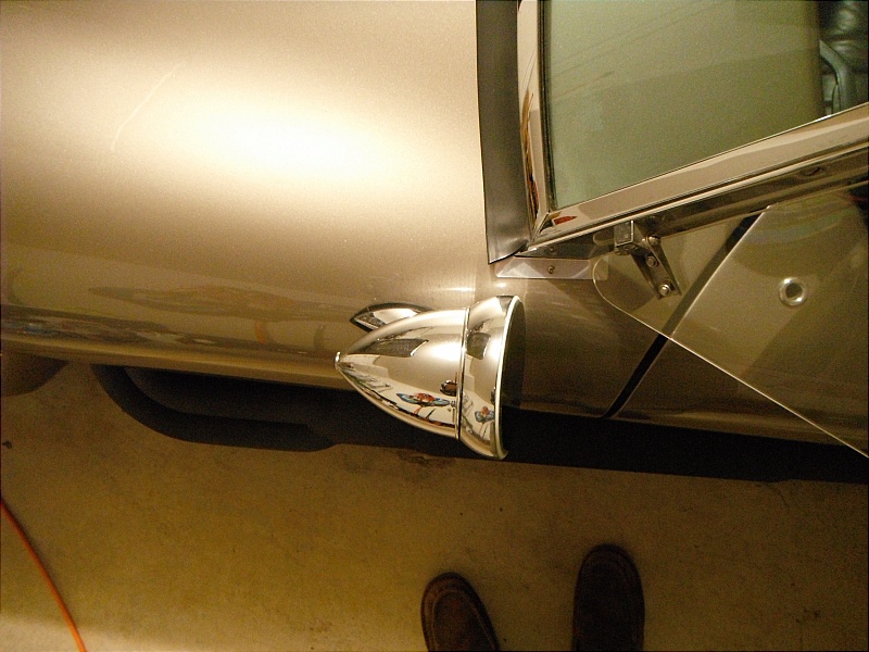

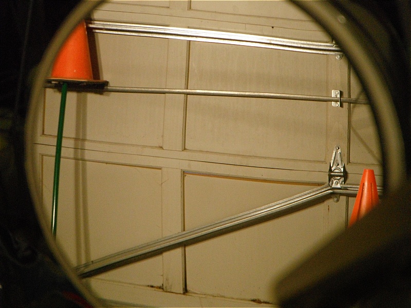

Done, and a beautiful job, if I do say so myself. Here are some shots. I turned the flash off and put on my work lights since it's in the garage. To give you an idea of the view from the driver's seat, I put two orange cones out. One on a tangent line of the car, adjacent to the back fender, sitting on my work stool. The second is at a right angle to the end of the car, six feet over. This is the blind spot. It's easier to see with a pic, but this gives you an idea. That last pic is exactly what you see from a normal driving position in the seat. Of course, I might want to adjust it a little more one way or another, but I won't know that until it stops raining and I get it out on the road.
