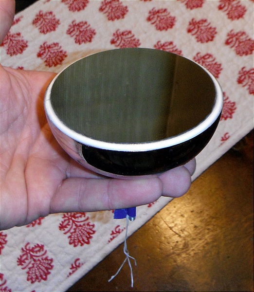

It sure is. Aardvark charged me $40. In the meantime, I'm using dental floss to compress the cork and spring so I can silicone the mirror and gasket in. Once that's dry, I'll release the floss from the back hole of the housing and the spring will uncoil and the cork will push out against the mirror reducing vibration. Here are two pics. Chas will love the fact that I'm using dental floss in this project.

Glass and chrome cleaned. I'll let the silicone cure one more night before I untie the floss, thus releasing the internal spring and cork. BTW, the gasket, spring, and cork look like they could be fabbed pretty easily from Home Depot components instead of spending $25 on them.

I trimmed the straw to pass around the screw that extrudes from the back of the housing so that the three pieces of floss, which are looped around the top of the spring in 120 degree increments, pass inside the straw, along the screw, and are constricted at the top by the straw so that there is a nice, even "draw down" of the spring. I then wrapped the floss several times around the base of the screw, where it exits from the straw, and put a little blue tape to hold it. The batteries are for a small flashlight, off camera. You couldn't figure that out?

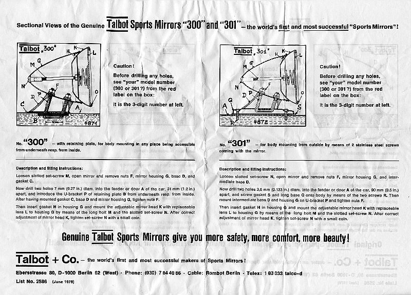

Yes indeed. I was even going to run strings to show the curvature of the line of sight, but I thought you would make fun of me.... But I will tell you that the upgrade is absolutely phenomenal. That little upgrade took my fifty dollar Talbot knock-off right up to the level of the genuine $400 job. Now, I don't know if the $10 UK mirror is the same as the $40 German mirror, maybe it is, maybe it isn't; but I do know there are different "cuts" of mirrors for quality purposes -- like steaks, first cuts, second cuts, etc. You know, I bet G-Pete would know. He's exceptionally talented in areas such as this. Maybe we could ask him if the cheaper English mirror is as good as the more expensive German mirror. In the meantime, here are the instructions for the Talbot mirror. The knock-offs are pretty much the same, except all the internals are of lesser quality. Just replace the mirror, gasket, spring, and cork.
