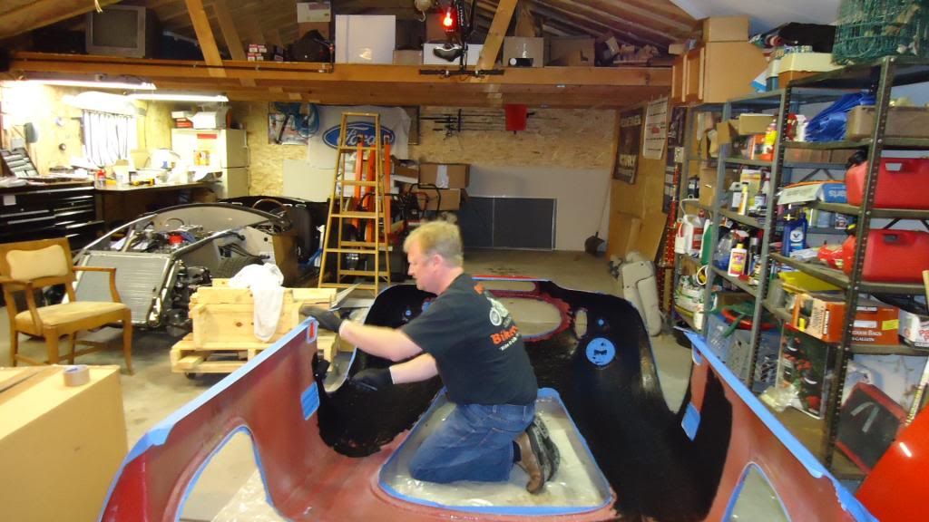

As others have done...I put a couple coats of Dupli-Color truck bed liner on the underside of my body. This helps protect from the "star" effect that you are referring to.
