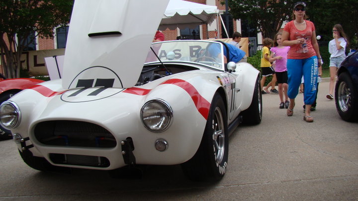

Originally Posted by FatBoy View Post
I'd have to agree with that, although they don't quite match the Goodyear billboards for looks.
Paul
Really Paul?

More about that here: Billboard stencil on non Good Year tires??

Originally Posted by LMH View Post
Pete, don't the Avons say "AVON" in big letters on the sidewall?
The comp tires do but I wasn't sure about street legal tires.
No, they don't unfortunately. I wish they did.
I'm sorry Pete, but they just don't look quite right in my view. The lettering is too big and too white. Maybe if they were scuffed a little.
Paul
Old 06-19-2014, 07:31 AM
G-Pete's Avatar
Join Date: Dec 2010
Location: Allen, TX
Posts: 1,296
The scuffing comes with time...the picture above was the first ride out. The car had about 30 miles in it, now with 400 they looking better and better...

Do you tell people that they are real goodyears?
I think they look great btw. What is the tread wear rating on them?
Absolutely not. Some of the guys wondering about the raised lettering and look very close and figure it out they are not the cheaper GY's.
On all sizes of the CR6ZZ the thread wear is 80. Traction A, Temperature B, the only street legal competition tire with that side wall height.
The lettering looks better and better....
I really do like the way they look, that was not a tongue in cheek comment.
But the tread wear of 80 should completely rule them out for OP. I didn't know they were that low, but being a comp tire helps to understand why (the NT01 is 100 if I recall correctly, while the NT05 is 200).
