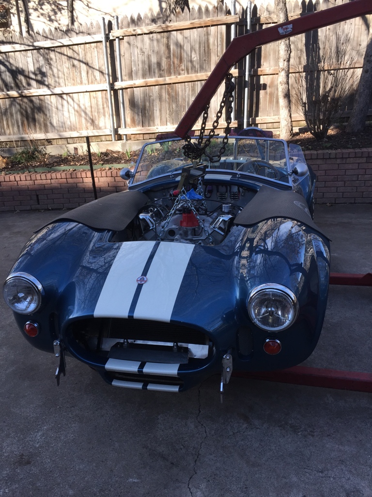

GaryT 01-01-2015 07:49 PM
It's been awhile since I updated my build, mainly since I didn't work on the car in October or November. The engine and trans came in early December and I put them in this week. I took Doug's advice and assembled everything on the floor and then installed the engine/flywheel in the chassis and then put in the clutch/bell housing and trans from inside the car. It went really well with just 2 people and took about 6 hours start to finish, including renting the lift.
http://www.clubcobra.com/photopost/d...0/IMG_7877.JPG
http://www.clubcobra.com/photopost/d...0/image410.jpg
http://www.clubcobra.com/photopost/d...0/image253.jpg
