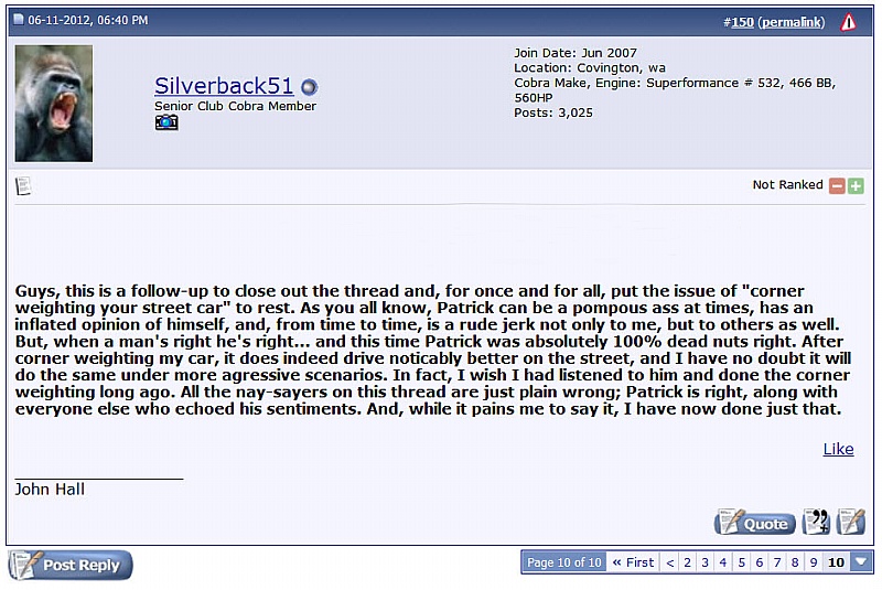

There are many different Cobras out there, but in my SPF case, I set the ride height to specs and when I checked the corner balance it was PERFECT and I did not have to change anything. I couldn't tell any difference in the handling of my Cobra since it was properly balanced before I put it on the scales. Not sure it is worth the $ to buy the corner balances and check it. Get the ride height to specs and you are there for the cost of a yardstick! Of course, if you have some other brand of Cobra, it might be different.
  #25 (permalink)
Old 12-05-2014, 05:25 AM
Posts: 22,025
For most people, it's not. Instead they should just call around to local alignment shops and ask "Do you use corner weight scales to set coil over ride height?" and if they say "What?" then just hang up and dial the next one. One of them will say "Sure we do." "We'll print out your weights for $50 or set them for another $50. And you can watch us do it." No alignment shop that has a set of corner scales is going to have them and not know how to use them. And no alignment shop that doesn't have them is going to tell you that they do.
Nowadays, a nice CSX, Kirkham, ERA, or SPF is a six figure toy -- why someone wouldn't drop a measly C-Note, or less, checking the corner weights is absolutely beyond me. But, then again, this is just one of those goofy subjects where people just don't do it. It makes absolutely no sense, but they don't.
