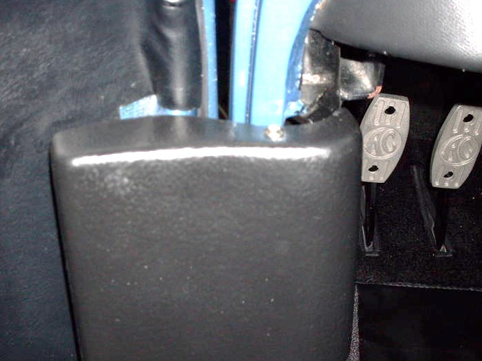

I bought two sets of hinge covers to try on my car.
The first from Acton were very good quality/well made/nice grain texture, but unfortunately did not fit my hinges:
See next post.

Got bounced out before I could finish the post.
Here's the second pic of the Acton hinge cover:

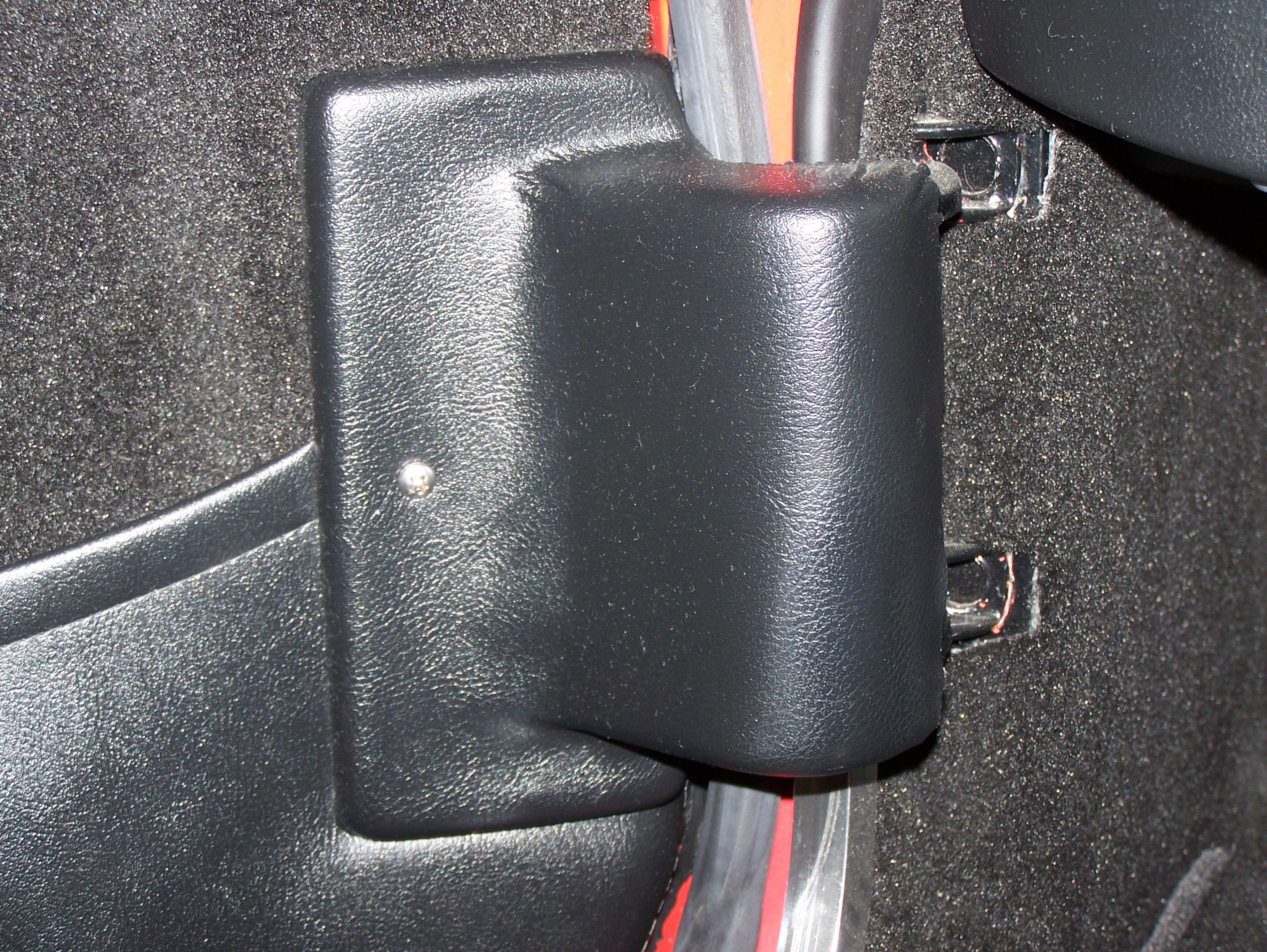

Then I bought a pair from Peter at ERA. Also very well made, fit my hinges better but not the way I wanted. So I cut the ERA covers about 1" up from and parallel to the square base and "rotated" the curved part down to the base to make a "perfect" fit. Fiberglass bonded it back together on the back. Stretched and glued the vinyl cover over it and:
