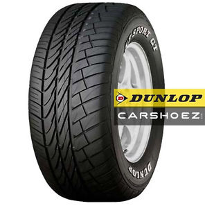

Default New Tire Any Good?
After the 1000 miles of Targa California, my old Mickey S/T's are about gone. Looking at replacements, the S/T's are hard to beat. Got 3 years and lots of miles out of them.
However, I just saw the new Dunlop GT that comes in the right sizes (255-60-15 and 275-60-15). They look nice with a modern tread pattern. Wonder if anyone has any experience with them?

I guess the eBay seller is doing well, he raised the price from $130 to $150. I emailed him about these tires asking if they came in "Left and "Right". He wrote back and said that they are Asymmetric and can be fitted on either side of the car. I wrote back and said that Symmetric tires can be fitted to either side but Asymmetric tires need to be turning in the direction that pushes the rain water away from the center of the tread. He did not reply. So, If you buy them and mount them with the tread in the correct direction, the tires on the left side will look different than the ones on the right side. With this tire, that may not be so bad.

I would never use those tires on a Cobra, these cars are so powerful they need something with a little performance in it to say the least...that tire looks like it would work on my mini van...

I have no direct experience with these tires to offer. But I do find a few things that make me curious about them and the seller. I can't find anyone else offering a Dunlop Sport GT tire in that size with a tread pattern that looks the same. Everyone else is offering a Dunlop Sport GT Maxx. It makes me wonder if those are old or from a different part of the world. I'd want to know more about them before I bought them.

Tommy,
Yes, I feel the same way. The tread pattern is interesting. The "S" rating is not so good. The fact that Dunlop does not recognize this tire on their website makes me think that they made a few prototype tires, decided not to go into production for some reason, and are selling them off through a third party.
The thing is, I have used a few Dunlop tires in the past and they were very good. In fact I have some on my Jaguar (different model) and those are great tires.
If they had a left and right tire with this Asymmetric tread pattern, I think I would have to try them. The fact that the left and right sides are going to look different on the car is holding me back.

Be careful if you don't see these anywhere else or from an online retailer.
I can't place where I saw the article or news story but there are copies/fakes made in China that make their way here.

Considering they don't come up on the Dunlop website, my guess is they are Chinese knock-offs. I think you did well to avoid.
Re. asymmetrical tires: there is no left or right (like a directional tire); they are marked with an "outside", for mounting. They asymmetric tread pattern will direct the water properly. Unlike directional tires, they can be cross-rotated, increasing the life of the tire.
