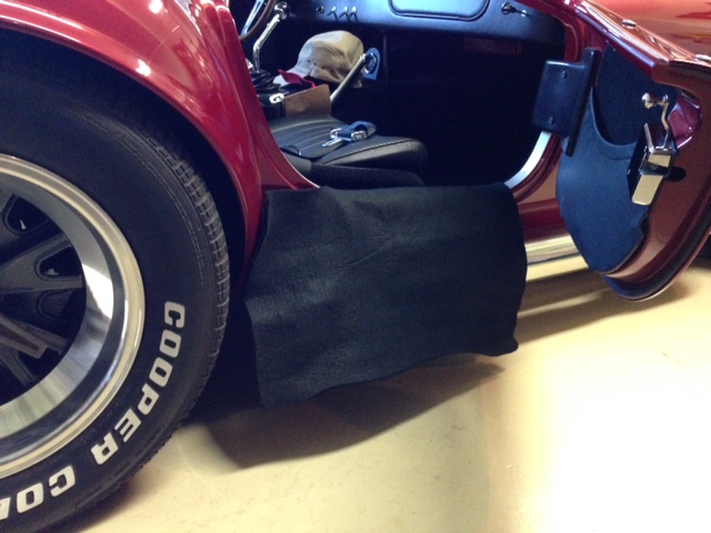

IF your buddy really wants a car with side exhaust and IF he can't step out over the pipe, then below is an easy solution. A welder's blanket and a couple of snaps on the inside of the door sill. Rolls out easily and works great - can't even feel any warmth through the blanket. I use it for passengers that I don't think can get in or out easily.

w-lewis 06-15-2015 09:36 AM
Good idea!

I am a sailboat racer hence am pretty tight with several sailmakers: I am contemplating a sock arrangement made of welders blankets that slip over the pipes forward to the support then are wrapped around and snapped forward of the bracket...At this rate I'll have no calf skin, and the first time the wife does it, well you know what happens then...

A better solution might be to sew a dowel in both ends. One dowel acts as a weight to hold the blanket over the door jam and the other acts as a weight to pull the blanket down. I see it as put it on, get in and lift it out and roll it up on the dowel.
I am going to try snaps and think about dowels after that.
