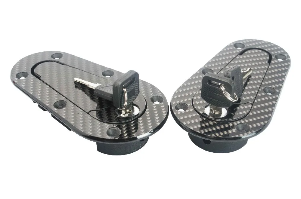

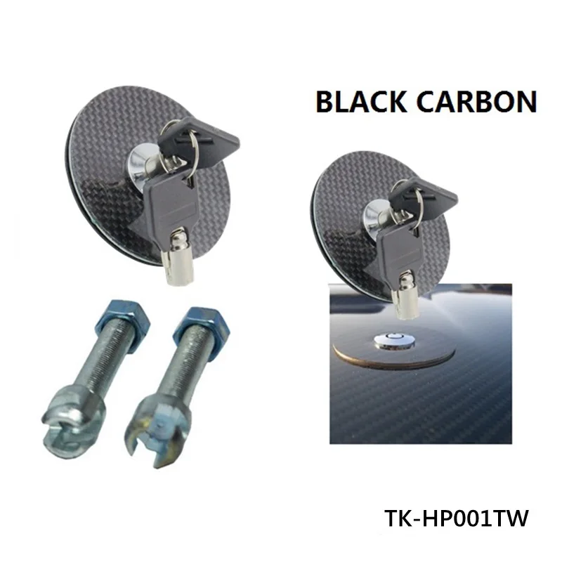

I just got told by my engineer that they aren't allowed. To sharp. So in case someone hits the bonnet hard enough to slide right up and hit the windscreen. They might do some more damage.
JD
Old 10-17-2016, 10:40 AM
cycleguy55's Avatar
Join Date: Feb 2014
Location: White City, SK
Posts: 2,919
JD
You might try something like one of these:
  1. https://www.aliexpress.com/item/BLAC...8-ba23bf9fe9f3
  2. https://www.aliexpress.com/item/PQY-...4-8afa69e22110
Jaydee likes this.
Brian

I like the second one, but I really don't want to start cutting into my bonnet. I have it looking original and I'm hoping someone will chime in from Australia saying it should be fine. I'll ring around but some of these rules really gets annoying. The first one looks nice and I can probably use without modifying the bonnet.
Thanks.
Thanks.
JD
You should be able to get either style in basic black as well, if the carbon fibre look isn't what you're after. Chrome or stainless steel may be an option as well.
