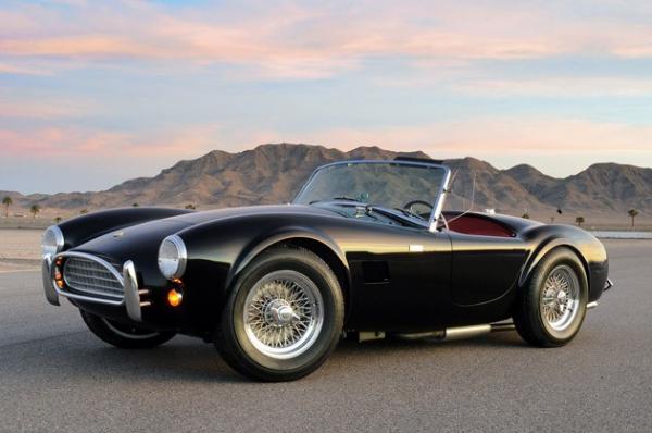

I would appreciate any information regarding the specifics for the original 1962 Shellby Cobra Slabside Wire Wheels (diameter, width, number of spokes, manufacturer, etc.) -- and/or the specifics for the Wire Wheels and tires on the 50th Anniversary Shelby Cobra (sold in 2012 -- black with red interior). I would like to put a set of these wheels (and tires) on a Shelby Cobra Slabside Tribute car. Please see photos of the wheels and tires for the 2012 50th Anniversary Edition Shelby Cobra Slabside below. Thanks in advance for your help and consideration -- Sincerely, David

Original Cobras used Dunlop wires. The Anniversary cars use a Dayton Wire Wheel, 15x6 72 spoke part number D464

Mainly, two different production Dunlop wire wheels were used on original Cobras. Generally, A 1962 car would have had a 15"x5.5" wheel. The later cars used a 15"x6" wheel. Lacing on the two wheels is different. Chrome or painted finish was also used and those are different from each other as well.
Correct, the 5.5" wheels .were "lip lace" wheels and the 6" are center lace.

The original 1960's wire wheels were manufactured by Dunlop and the part number for the 15x6 was D464. The earlier wheel was an outside laced 15x5.5, sorry I don't have the part number.
It is a little strange but the 50th Anniversary cars more closely resemble the later 289 Cobras than they do the earlier 260 Cobras, it gets confusing when mixing details.
