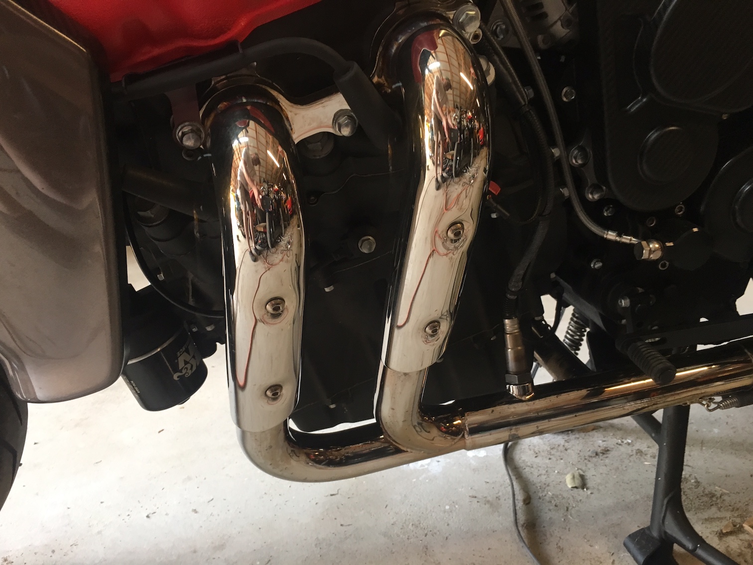

I don't have stainless pipes on my car, but a while back I bought a Motus (motorcycle) which has stainless pipes. They were water-stained and a couple of other owners recommended a polish called Autosol. It made a huge improvement, particularly after I quit using elbow grease and enlisted the help of an electric buffer.

These are two of the pipes on my Motus, before and after Autosol. The water spots were significantly reduced and the discoloration came out, as well.
