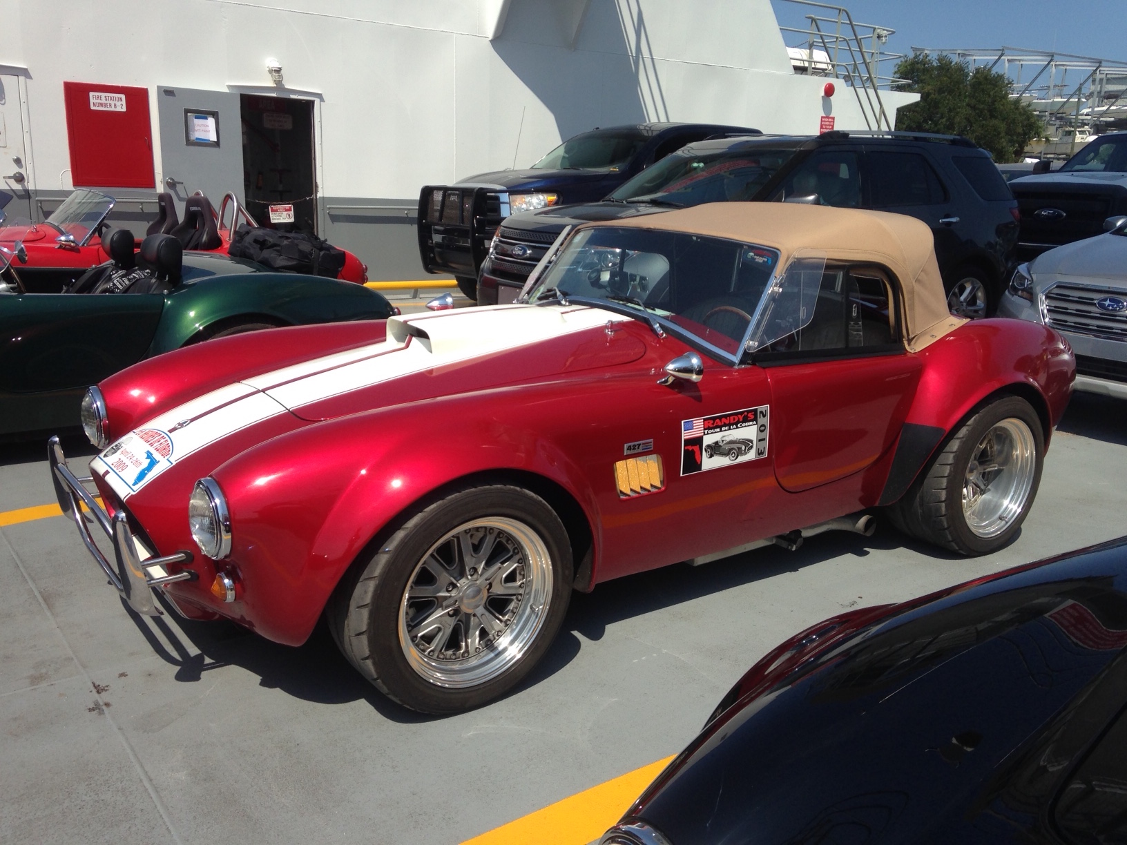

A few photos from install of my ERA if that helps. Hope you can find a kit for your car as install is difficult enough with a kit, much less starting from nearly scratch. The front of the side curtains tucks inside the outer edge of the windshield slightly. The windshield needs to be set and final adjusted for angle to meet the side curtains at the front although the plexiglass can be sanded/shaped in some cases to facilitate the final fit. The windshield frame has to be set in final position before starting on the top fitting.

Here's what mine looks like: http://www.firstcoastcobraclub.com/d...ile.php?id=128
My E-M was circa 2000.
