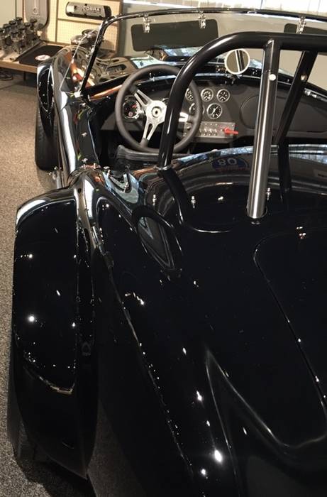

To that point, here’s a 289 Cobra from The Cobra Experience that was purpose-built for autocrossing years ago. It has enormous rear flares that I think look pretty cool.
Alfa02 likes this.

snakeeyes's Avatar
Location: San Antonio, TX
Posts: 1,822
Old 12-22-2019, 11:11 AM

That looks pretty nice!
snakeeyes likes this.
