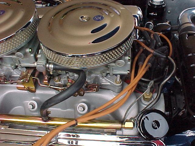

Originally posted by Alex Donghi
If its not too much trouble can you take a close up of the linkage and post it? Same view but a close up of the linkage
Thanx
Here's a closer view of the linkage...

computerworks's Avatar
Location: Northport, NY
Posts: 10,362
...not the same picture, but another shot from my files.

Old 02-28-2003, 07:41 AM
Alex Donghi's Avatar
Join Date: Aug 2002
Location: Atlanta, GA
Cobra Make, Engine: SPF #821,Southern Automotive 427 Side Oiler w/2x4
Posts: 687
Thanks for the close up. What I wanted to see was where you had the linkage hooked up in the rear carb. My old old r motor from the sixties in a galaxy had different linkage all mechanical. Which springs you runing in the secandary vacume pots?
thanx
Alex
