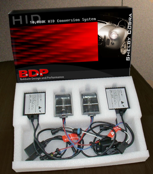

I received a few emails about the conversion so I will address them here instead of emailing you back ( I am lazy today )
1. How much does it cost? The "quality" kits range from $375-$600 but be careful that you know what you are buying. There are many low quality kits out there that start around $250. You can find some deals on Ebay but make sure you get a warranty and good ballast.
2. Is it difficult to install? Takes about an hour but is straight forward.
3. Do you have pictures? I only have pictures of the kit I developed about 2 years ago. It is below. No, I do not yet stock these but will sometime this next year and include the 7" crystal housings (too many projects going on right now)
I did a lot of research on these lights before i assembled the components. Whatever you do, get good quality bulbs, don't touch them directly with your fingers (when installing) and keep the ballast inthe engine compartment or cowl - not under the fender.
James
