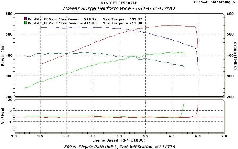

I know you guys like this stuff, so here's some info on an 07 GT500 I just did for a customer....
Car baselined at 411rwhp. The car was bone stock, except for long tube headers and high flow cats. Unfortunately, exhaust does nothing for these cars, and it actually hurt the power a bit, as these cars usually baseline about 430-440.
I added a carbon fiber intake/MAF system, and a 2.6 blower pulley. Threw it on the dyno and tuned it.
The car went from 411rwhp/411rwtq, to 541rwhp/532rwtq. That's a gain of 130 hp and 120 tq to the WHEELS. From a pulley, intake and tune. I can't think of any other car in the world that can gain 130hp to the wheels for $1000 in parts.
And on the street, this car is an absolute blast. A super torque monster ready to pull against anything it comes across. It may be 4000+ lbs, but who cares when you make 530 ft-lbs of torque to the wheels.
I can honestly say, this car totally lives up to what the original GT-500 was; a heavy, torque happy, stoplight brute.
Here's the before and after on the dyno:

That is impressive.
I've always had the idea that it was generally easy to easily boost up torque/HP on cars that came factory equipped with either a turbo or supercharger, as the factory generally doesn't run the boost very high, and it is very easy to increase boost, for more HP. I heard of someone sticking a needle into a vacuum/boost line to somehow trick the system into giving alot more boost, i.e. power. I think it was a turbo RX7 or Eclipse or something like that.

Thats the way it should be a $1000 and a extra 100 + horses....nice
