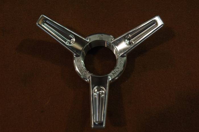

Here is a close up of our F1 pop-up safety devise. The pin must be pushed down (it is spring loaded) to take the wing nut off.

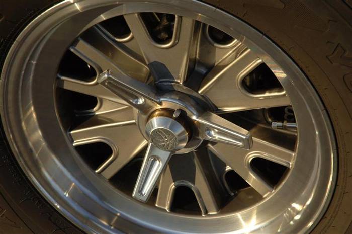

Here is a picture of the latest knock-offs we are making. They are billet aluminum. Notice the new writing on them! First car to have the writing on them was delivered today.
David

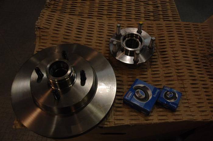

I called the parts house and ordered what I thought was the front end parts for a 89 Mustang. I ordered the wheel bearings, hub and rotor. This is what I got.
I thought you guys used 5 lug wheels???
Also, notice I did get a 5 lug hub and bearing assembly--that is what they call the hub. I guess the parts house didn't notice the hub was already in the rotor! Oh well, what can you expect from them?
Now I am lost more than ever.
Help!
David

If that's the case, then it won't fit a FFR setup since FFRs use spindles with hubs just like the Newer Mustangs.
SERGIO

79-93 Mustangs use 4 lugs,
1994-2008 Mustangs use 5 lugs
SERGIO
