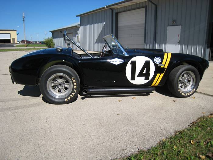

I am all for spending money on my car. Unfortunately, the price I was quoted for the Kidney's was $1500/wheel - yes $6000 for a set!
Cobra Pack
