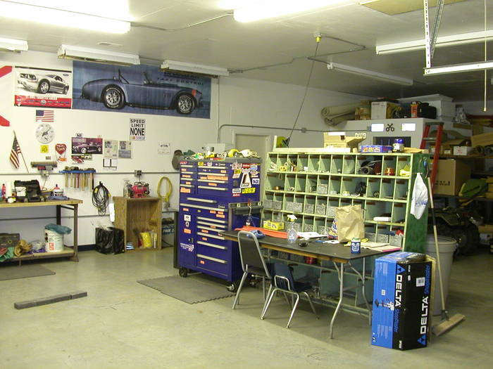

Old 10-27-2007, 02:07 PM
jdog's Avatar
Join Date: Feb 2004
Location: Sacramento, CA
Cobra Make, Engine: Shelby CSX4795 (Sold)
Posts: 1,542
Wink The Cave!
Here is my Cobra's cave!
6ea. 4' shoplights hung from the rafters in and array. And some directional track lights over the workbench for detail work. I also have a couple of droplights for under the car work.
I little bit underlit, but it reminds me of a cave, and don't most snakes live in caves?
