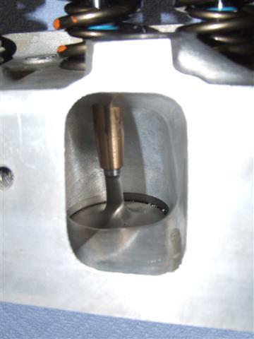

Thumbs up Stage III ported from FE Specialties!
I agree they need to be opened up by someone good!
These make 600hp!
jdog

Jdog - looks good! I agree with your comment on someone doing a good job on the heads. Chris Dawkins (Chris Dawkins Engineering - Seaside, CA) is doing my engine and going to rework the Edelbrock heads.
