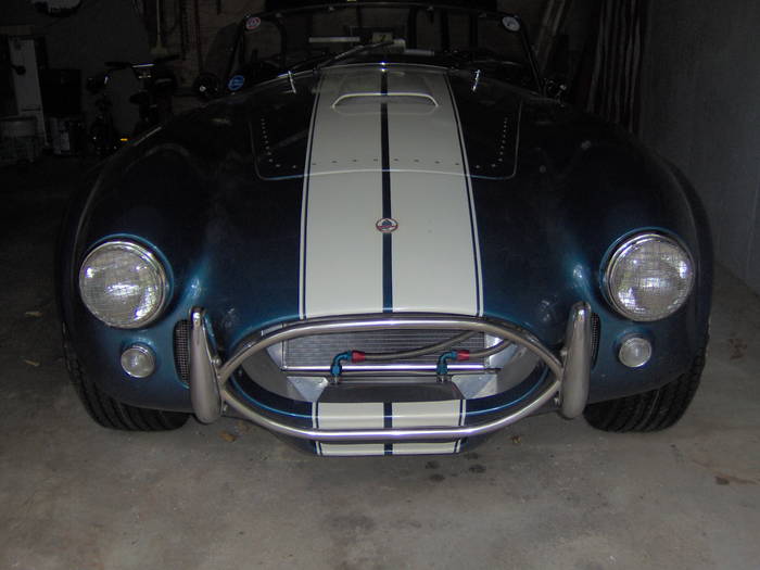

I have to buy an oil cooler for the process of finishing my car. I know the original 427 SC had a Mocal with 12AN fittings. Does anyone have any idea of size, either in H" x W" or rows and width, or even better a comparable part number? I see that Finish Line has a 5" tall unit with 10AN fittings - is this the right unit? I see ERA ofers a 4" and a 6". What does Shelby and Kirkham offer?
