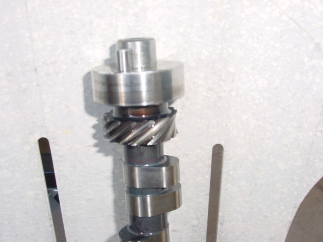

I understand that you are only hearing my side of the story. I would post the pictures of the camshaft and dizzy gear, but everytime i try to post a pic, the forum say's it is too large and won't allow it. The pics are pretty self explanitory. The cam gear is shreadded and the dizzy gear shows no wear. If the parts were compatable as Comp insists they were, then regardless of what caused the failure, both components should have been equally damaged. Even Comp could not explain why only the cam was damaged. If you want to send me your direct e-mail, I am happy to forward the pictures of both components to you so you can judge the evidence yourself. Unlike Comp, I have absolutely nothing to hide and will submit both componets to any testing. So that in itself should tell you something. If you look on the SAAC forum or the FFcobra forum, you can view two pictures of the cam. I think the picture shows very clearly that it was the cam that failed. So why is Comps response to the BBB that the dizzy gear failed? But judge for yourself. I am fully willing to supply any documentation and components for independent review.
Mike

Just to clarify the situation. I did not build the engine or install the gear on the dizzy. The engine was built by a professional engine builder. He specified the distributor to use in the paperwork I received. Unfortuately, as i found out after the fact is that the reason he spifically specified the model distributor was that it had the proper cast gear on it. There was no direct discussion on the actual dizzy gear as he assumed i would just drop the dizzy in and not read the instructions. Which is usually what i would have done. The fact that the engine was so expensive and the dizzy having that big red warning tag is what prompted me to call Comp as that is what the warning tag said to do. If I would have called the builder instead of Comp, I would have installed the dizzy with the gear it came with and never had this problem. So to be fair, if I would have ignored the instructions on the dizzy and called the builder instead of the cam maker, the mistake would never had been made. However, the cam maker is supposed to know more about what works with their product then anyone else, so why are they saying the wrong thing? The dizzy gear was installed by a machine shop that does it all the time. The only thing I actually installed was the dizzy itself. Both times. So again, even if I might have by some small chance of installed the dizzy wrong the first time, then why is the dizzy gear undamaged? Anyway, i just wanted to be clear that i did not build the engine at home. The builder builds hundreds of engines a year and has built this exact same engine many times before. He always specified the same dizzy which has a cast gear on it. The only time there has been a failure was mine. So all the other engines with a cast gear have run fine for thousands of miles. Mine only made it 150 miles. The damage to the rest of the engine was caused by the metal filings from the cam. No other causal damage was found and it was rebuilt by the same builder and has well over 1000 miles since it was fixed and is running fine.
Mike

Pics of Mikes cam carnage can be found in my gallery
Bagram AF Afghanistan

It is very possible to destroy one side of a gear and the other to be fine, as happened in your situation. It's all a matter of the alloys that compose the gears.
What kind of cam and gear did you end up with? I believe you had a steel gear, but what was the cam? Was it a roller, or a flat tappet?

I wouldn't say the engine builder 'always' specifies the same gear all the time. The choice of the dist gear lies entirely with the choice of camshaft design. Roller cam requires a different dist gear than a flat tappet cam, for instance.

Good call having the dist gear professionally installed, of course a guy CAN install his own gear, but you can also screw it up. Easy to see it's a roller cam from the profile of the lobes, very round and not so pointed like a flat tappet would be. Roller cams run a softer gear, like bronze (or the new plastic). Looks like the engine builder had the right gear the first time. An example of why I trust the engine builder over the cam supplier. Of course, even they make mistakes, it's tough to be 100% correct 100% of the time.
If Comp Cams said the dist gear is what wore out the cam gear, that would be an accurate statement in this case. Neglecting the fact it is THEY who recommended the dist gear of course!

A roller cam should have either a steel gear or a bronze gear. A cast gear will wear out in no time.
I have a roller cam in mine and a steel gear on the distributor. No issues with this combo. However I will be changing to a bronze gear when I but in the new distributor.
Is it possible that the steel gear was installed wrong on your distributor? Generally the steel and bronze gears do not have the roll pin hole drilled. If I remember right, the tolerance for locating this to the distributor shaft is .010. That is close and needs to be checked after installation.
