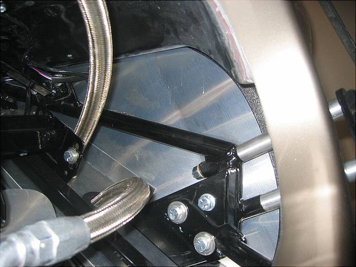

patrickt 10-18-2008 06:07 AM
Originally Posted by 427 S/O (Post 890174)
I thought about making and using the actual 'jack', I have a pretty good picture of one in use. Then I thought, that jack is huge, where would I store it?. Let that idea go......
This is the back of the front ERA Quick Jack -- I don't think it would support jacking up the front end.%/ And I don't want to have to ship it back up to Connecticut Custom Car to fix "my finding out." ;)
http://www.clubcobra.com/photopost/d...quick_jack.JPG
marcalan 10-18-2008 06:13 AM
I asked Doug at ERA if I could use the quick jacks on my fia car, and he said not to do it.
