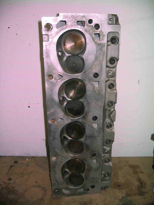

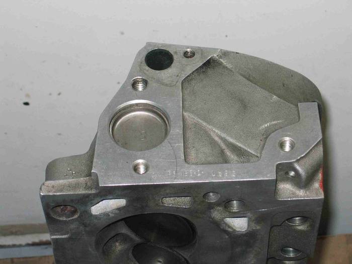

These are 351/302 aluminum heads with seem to be 57cc combustion chamber. Looking to identify these heads, there are no casting # only them and these are the only #'s stamped on the outside, s/n SB-188-2-1890, A3865. Thanks, Mike

Mike do you have more info?

Look like Trick Flow's to me--TFS.

Jac Mac what makes you think they're trick flows would'nt it be written.

Have a photo in a magazine here with a set of early TFS in line valve street heads as sold by JBA ( John Bittle American Inc ), they dont appear to have TFS logo etc cast /stamped on them, perhaps JBA had an agreement to sell sans casting logo's etc at time. Same heads appearance wise with drilling above exh ports etc as per those ones.

Do you know the valve sizes for the intake and exhaust? that might help some of the more knowledgeable guys on here determine just what heads they are.

The valves size are, Int. 1.93 and the exh. 1.6

I had the Twisted Wedge Trick Flow heads on my Cobra and they had larger valves and looked just a little different. Maybe the porting and polishing made the ports look a little different.

These are not ''Twisted Wedge''- which naturally look different to these due to the valve angle changes etc.
