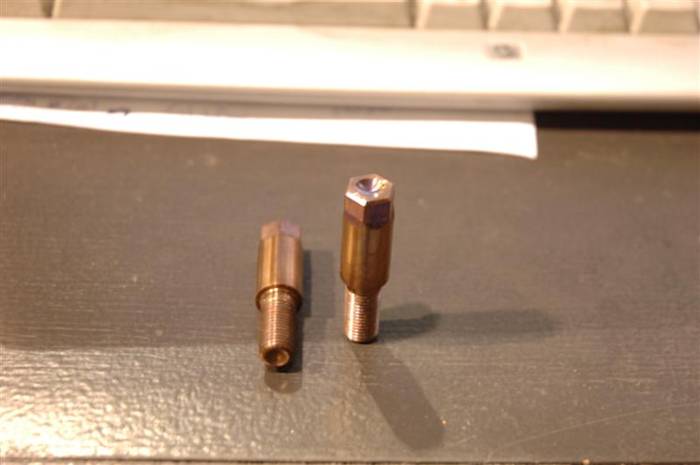

Here is the last batch of pins I made for the guys who want our original suspension. I was tired of the internal allen stripping on the original drive pins so I just made them with an external hex. I don't know if you guys have enough room in your wheel to do that or not.
Just for reference, the pin is 0.500 in diameter and the threads are 3/8-24.
Does anyone know how much engagement they have on their nuts to the wheel?
Here are the pics. What do you guys think about these? Notice they are all deburred by the CNC with a nice radius. The dimple in the top was to reduce weight (I know it isn't much) and to make them look good. They are made from 17-4 stainless--really tough stuff.

How about some sleeve nuts, .750 OD, .500 blind hole 1/2" threaded with the hex and 60 degree chamfer, those look very nice.

the nuts we are using are basically a threaded sleeve with a short hex broached in 1 end
which is installed over the original shortened wheel studs.
Yours appear to be for a hub that is threaded, therefore not suitable for a spinner adaptor application. But I'm sure when someone close too you sends you a sample you will come up with a superior solution as you usually do.
Craig
  #35 (permalink)

Yes, the pins we made actually thread into the brake rotor on the back of the hub (original style set up). The original Cobra hub has a 0.500" recess in the hub to accept the pin. The pin goes through the hub and then threads into the rotor. The pin then has a lock nut on the back side of the rotor to keep everything together.

Just thinking out loud here...wondering if a industrutable pin design would mean the rim itself gets destroyed? I still think there is another issue here with the pins getting loose in the first place...
David, if you used the basic Trigo style pin, but only drilled and tapped the internal threads into it to a depth required by the wheel stud. (flat bottomed tap) Then machined the hex on to to end of the pin just enough to get a socket on to it. I have a few new Trigo pins to use as reference if you like...

The rim can only get hurt if there is relative movement somewhere (either by the pins moving or the wheel moving). Neither one is good. Making the pins out of good material will not solve either of these problems. (Unless the material is so lousy it is yielding and the pin is coming loose). Making the pins out of lousy material can have all sorts of other undesirable effects. Making the pins out of good material only has benefits.
