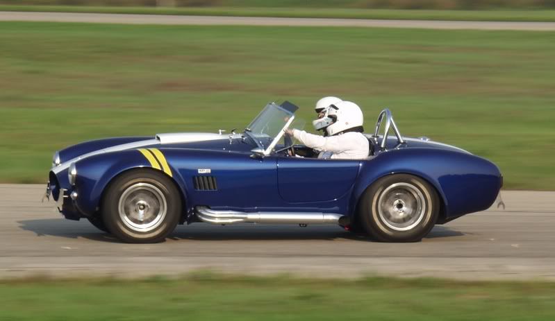

Originally Posted by RonNichols View Post
Here's eventually what you're getting yourself into as far as the look. Not the collector for the purest, but it sure ain't bad.
R
Couldn't you just shorten up the 4 primary pipes just after the 90* bend but prior to the merge collector, then add that inch or two to the muffler length? Easier to do if you buy a custom muffler length (i.e. Stainless Specialties, who will make any length you specify). Then all the proportions (which, like many, I'm big on) remain relatively the same and closer to "factory" (for what that term is worth).
-Dean
