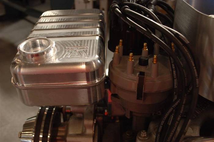

Here you can see we took the original distributor cap off and placed the large electric distributor cap on the motor. We wanted to make sure it cleared everything--and it does!

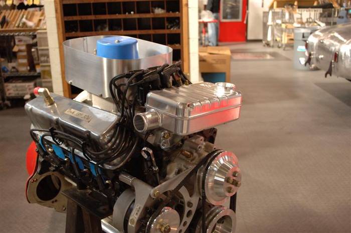

Default Radiator hose
I like the fact that yours radiator hose exits on the drivers side. If it didn't It would not be usable for me.

Default what happened tothis picture
as on post #1 where the hose exit is on the left ???????

Slightly different angle.

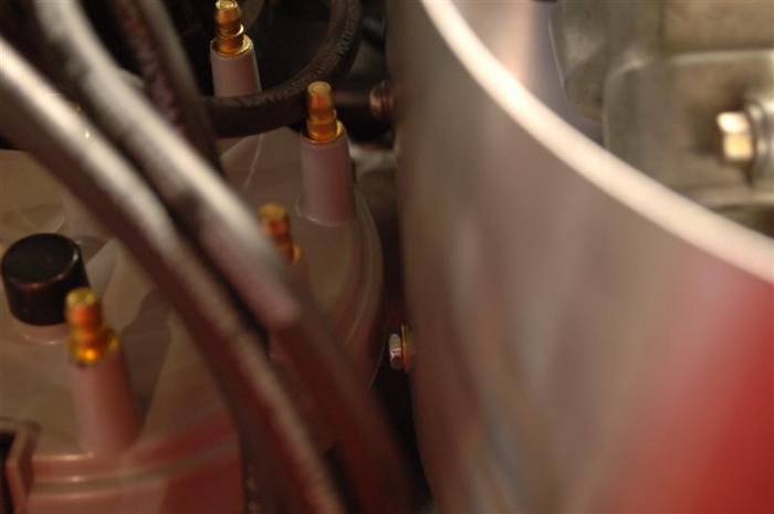

Here you can see we also modified the new 2 piece cold air box (turkey pan) so it would clear the big cap as well.

This is a picture of our latest addition to the line up---the right hand outlet.
We have been making left hand outlet tanks now for a long time. I'll post a picture of those soon as soon as we get the o-ring thing figured out.
By the way, this is 289 motor, not a 351.

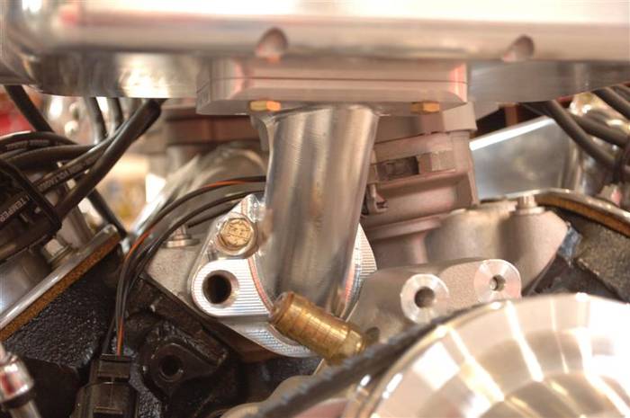

Here you can see we kept the port for the little 90 degree bypass hose.

CobraEd,
The tank exits on either side. You just have to specify when you order. The original cars exit on the left side, and many guys wanted a tank that exited on the right side (passenger side) like the original Galaxy.
In this picture, I figured I'd show the new right exit we just made.
This is the prototype tank. This one is designed to use a gasket. But due to complaints from the peanut gallery, we are modifying the neck to use an o-ring instead. Frankly, I can't blame them! The gasket is really hard to deal with.
